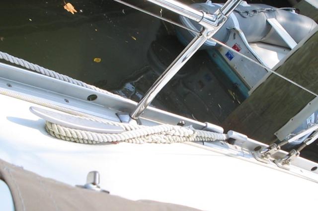

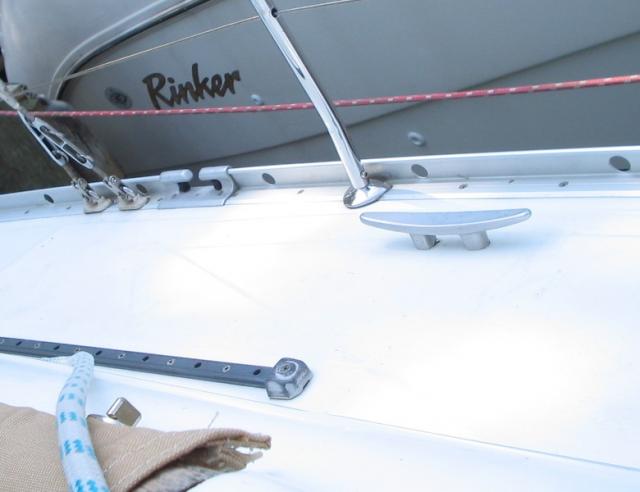

Not a 321, but on my 323 I added mid-ship'ers because I do alot of raftups with the sailing club. On the port, I cut some of the wiring trough in the galley locker to put 2 nuts and a backing plate up there. On the stbd I was able to place the cleat behind the circuit breaker panel, so had easy access. I got the cleats from Syselios. The bolts are cast into the cleat and match the rest of the boat. They are perhaps a foot behind the toerail fairleads. Put in big cleats, as you'll probably always have 2 lines on it.
Do you not find the cleat a hassle when moving forward on the deck especial at night time even if it its mounted close to the the toe rail...?

No... it's maybe 3 inches in from the toe rail, so there's still a wide deck there. You get used to it. Do you ever kick a winch? No, because you know it's there and step around it.
Indoard foot steps at the cleat or before; the outboard foot between the cleat and shround; the inboard at the shrouds; the outboad where the track car is.

Hi Ron
I would love to see a photo of your cleat position if it is not to much trouble and I think a few others would also be interested to see what you have done also.

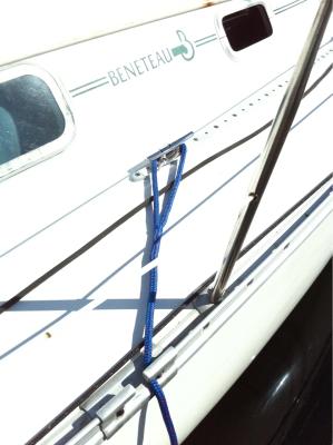

Another midship cleat option for the 321 would be to add one of these screw-on toerail cleats made by a company in England.
http://www.mailspeedmarine.com/deck-hardware/ys/toe-rail-cleat532689.bhtml
According to google, 73 pounds is equal to $121, so it's an expensive option. On my former boat which also didn't come with midship cleats, I screwed a piece of teak to the toerail and attached a fixed cleat to the teak. It worked fine for springlines.

Koni Koni
That looks like quite a smart idea and totally out of the way, no stubbing of toes in the middle of the night stumbling around the deck in bare feet while being slightly intoxicated.:D

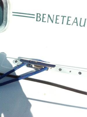

I just installed the Schaefer mid-deck track cleats.
So far so good. They seem to be well made and strong. See photo. All you have to do is unscrew the plastic end stops and slide em on.
Access on the Beneteau 321 to the port track nuts is through a teak cover. On the starboard side I started to panic when I could not find a cover and thought I might need to cut an access port. However I believe that there us a tapped aluminum plate in the fiberglass under there because I was able to unscrew and then replace the end stop from the top.
My one worry is that these cleats will snag a jib sheet.

Hi Ron20324
Thank you for taking the time to photo and post the cleat position, looks good and out of the way.
