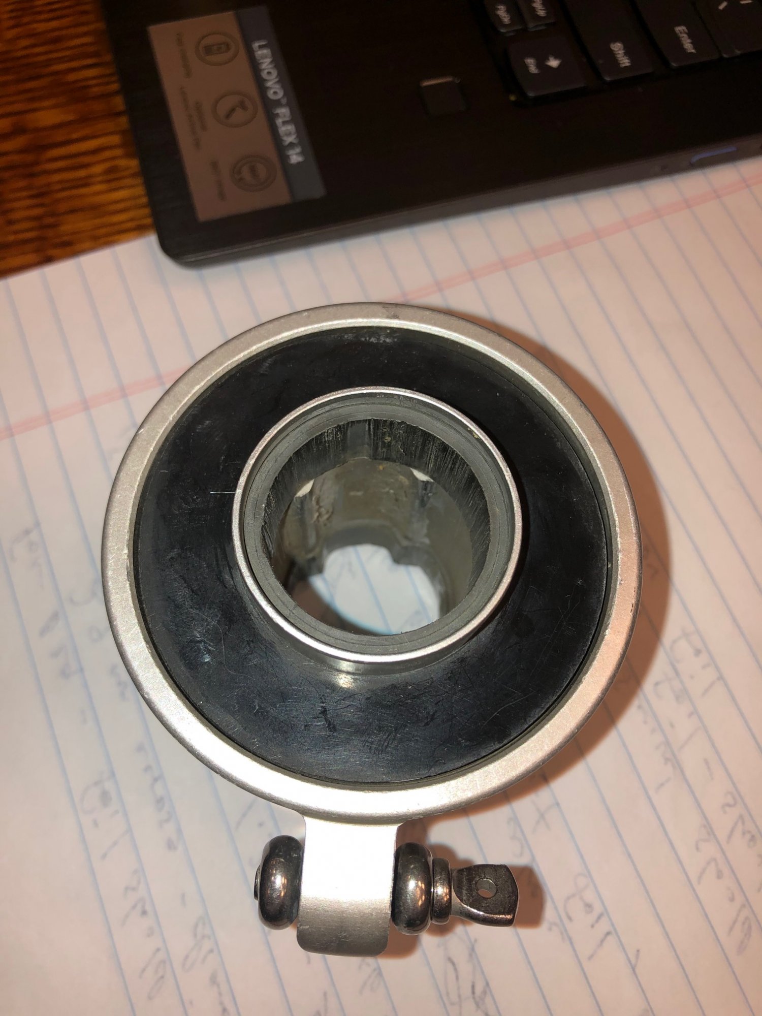

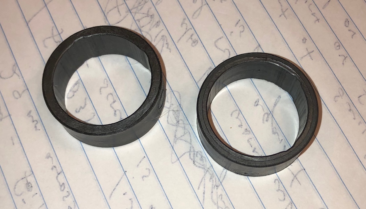

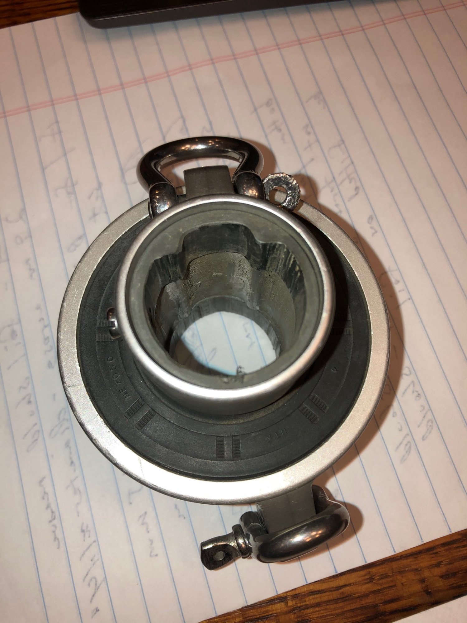

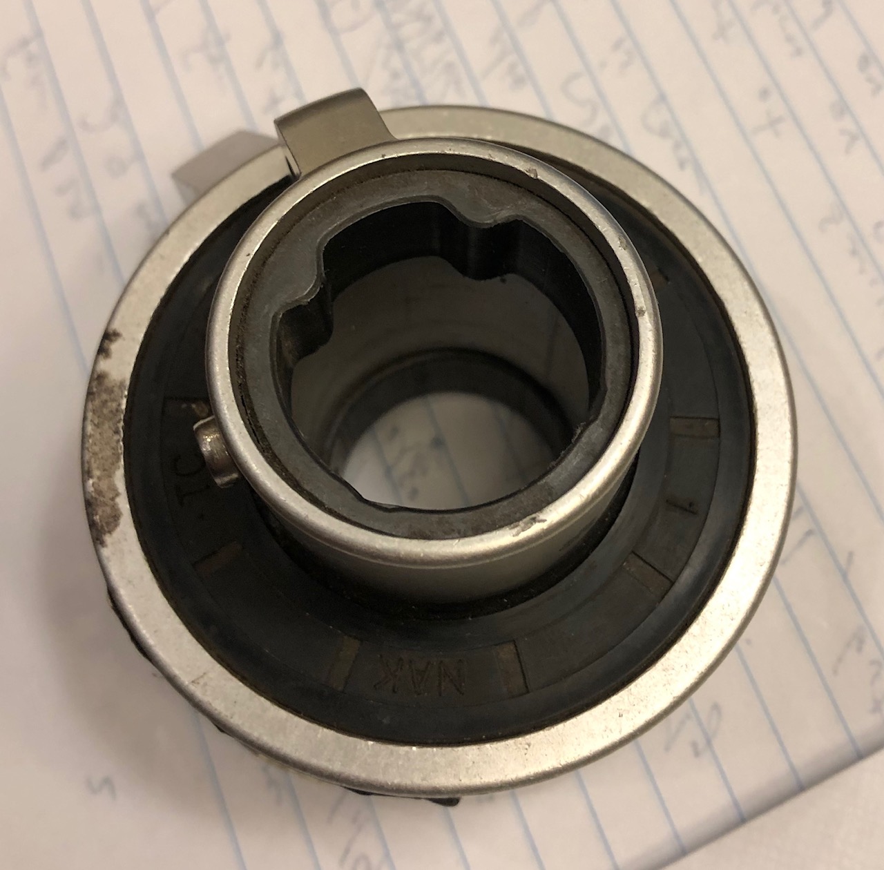

I have a Beneteau 311 made in 2000 and we appear to have the same type of furler. For several years I had considerable difficulty hoisting my jib, even with the winch, and even bringing the sail down required considerable effort. I became concerned that I would not be able to get the jib down in some kind of emergency, such as in high winds, if the furling function stopped working. After sending pictures and discussing the problem with Wichard (who has the ProFurl line), we determined that the bushings inside the upper swivel had worn to the point that the swivel was binding on the luff extrusion (foil) . I was able to verify the diagnosis by hoisting the upper swivel without the sail attached, and I could only raise the swivel up the luff extrusion with considerable effort. (Fortunately I had attached a line to pull the swivel back down.) The halyard and sail pull on the upper swivel at and angle, and if the internal bushings that slide against the foil are worn the swivel hangs up. These bushings appear to be made of a sort of hard rubber and so wear would be expected after almost 20 years..
I ordered new bushings for my upper swivel, which were not expensive, but they did not fit my furler. The newer design has bushings that look like rings, whereas my upper swivel and the bushings had "shoulders" that held the upper swivel aligned with the foil.
Fortunately I found a friend of a friend that had rebuilt several boats and had a machine shop up in a rural area of Michigan. He had several old furler parts lying on a shelf and one fit my boat. It was pretty stiff, but after rotating one part against the other for a while I was able to get the upper and lower sections of the furler rotating again.
I've attached a few pictures. The first one labeled shows the replacement swivel and the "shoulders" I mentioned. this part was hardly worn at all. The second and fourth pictures show the original furler from above and below, the furler that was hanging up. The third picture shows the replacement bushings that turned out to have a different design. The inner diameter has some kind of pattern that is suggestive of aligning with the foil shape, but the indentations don't appear to be big enough to be functional. Possibly the new bushings are for the wrong side of the upper swivel.
Good luck!
Good luck!

PS: I have replaced the bushings on my B29. The new bushings don't have the nubs. Easy to remove and install.

I only replaced the 2 bushings. The new bushings do not have the nubs. The problem was the nubs wear over time so that they slip over the raised part of the foil and jam. The new bushings allow the swivel to rotate on the foil without jamming, so they say.

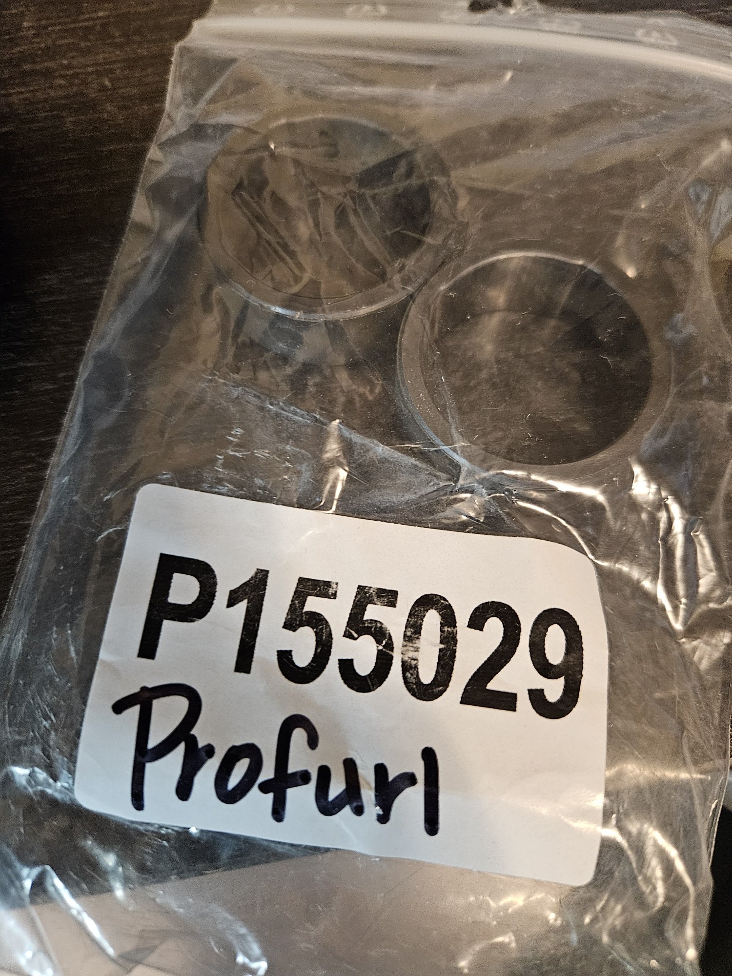

I did confirm the profurl p155029 were the correct bushing replacment for the b29l. I plan on doing the replacment hoping for a smooth transition. While the upper swivel is off the boat, I hope to repack the grease in the bearing section as well. Can anyone offer a quick tutorial. I am going in blind.
