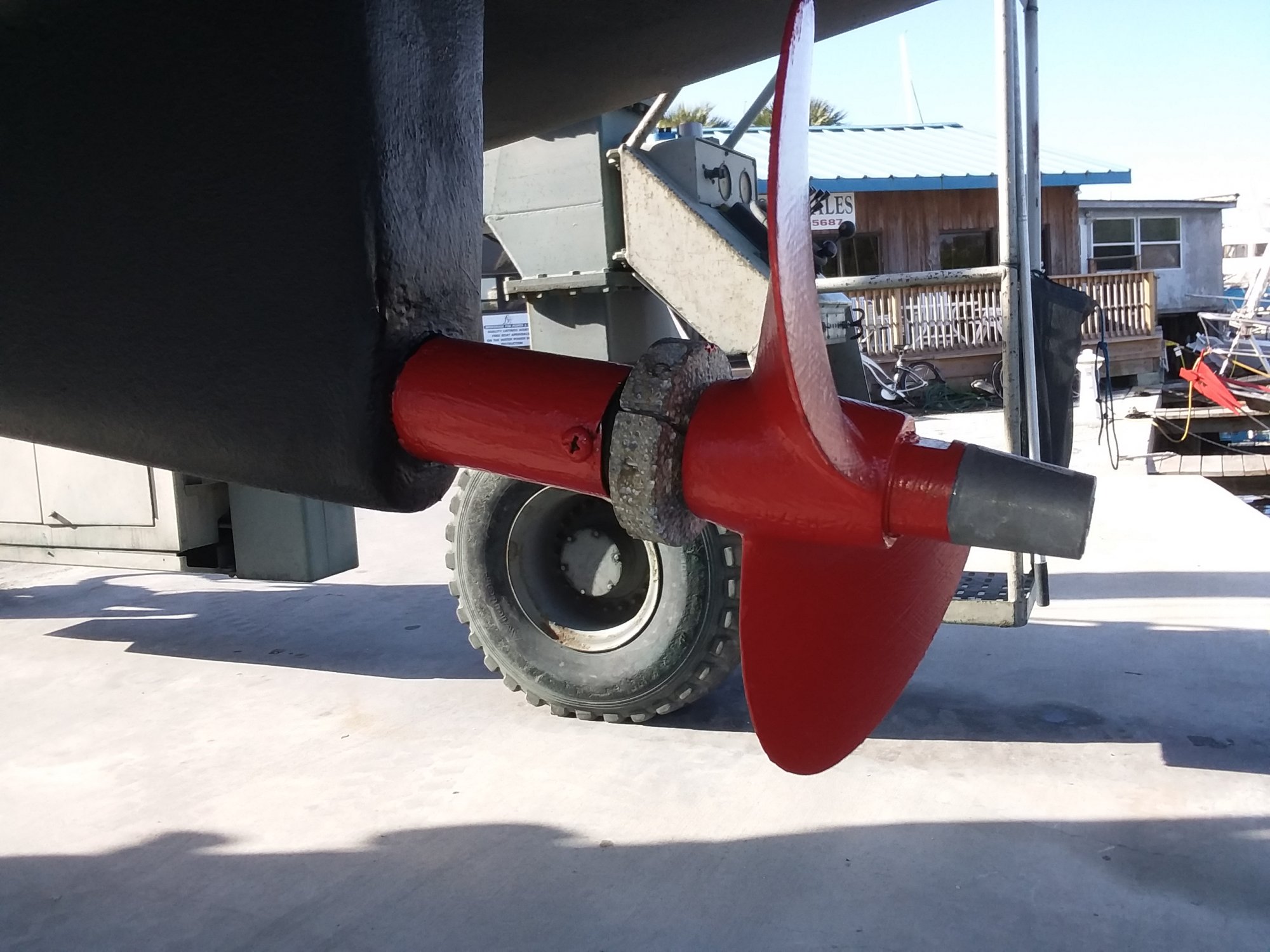

I sail down on the west coast of Florida The shaft zinc collar was added for additional protection. If I upgrade to a new prop, I might get a folding prop. I've had the the boat since the end of 2017. It's been an nice experience but a labor of love as they say.If you have a 2-bladed prop compared to my 3-bladed prop I can see how your boat would feel underpowered. Perhaps my experience will give you some guidance on what to try with yours. We might be able to negotiate the sale of my prop, but be forewarned that a 3-bladed prop would probably have more drag.
I see you have added a donut "zinc" anode in addition to the one at the end of the shaft, and the donut appears to be showing some corrosion, but not very much. Is your donut made of zinc? We often use aluminum or magnesium here in the Great Lakes because the zinc is less active in fresh water. When I purchased my boat it had only the zinc at the end of the shaft. The boat was sailed on Lake Michigan, which is cold enough that anti-fouling is sparingly applied and often not every year.
