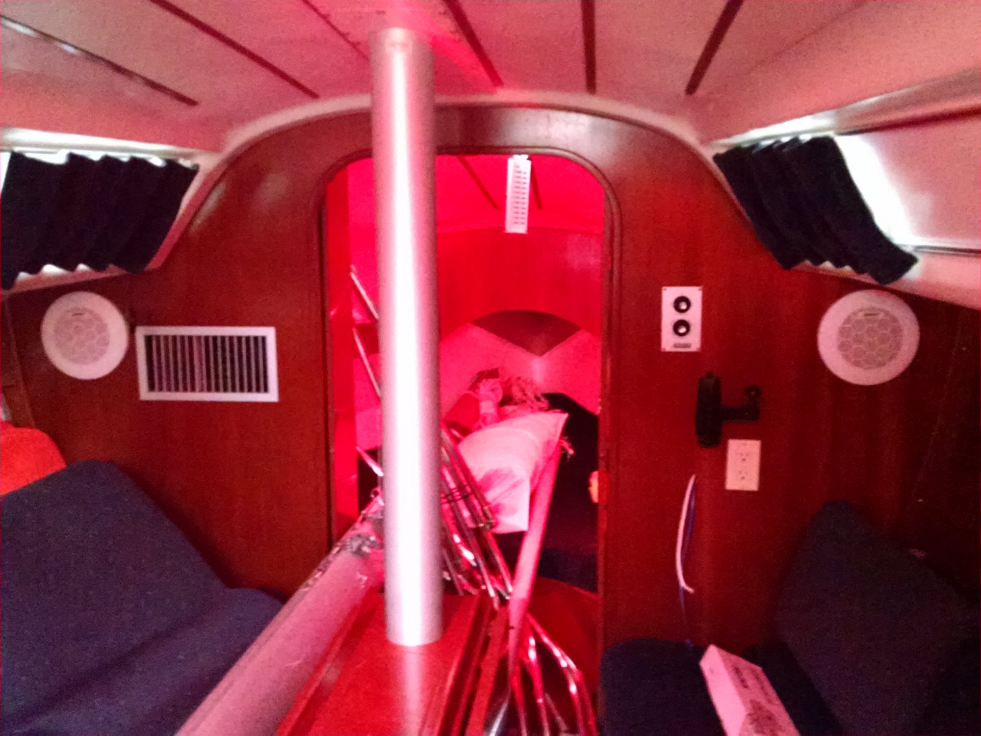

You may be able to replace the bulb with an LED "bulb" and not replace the fixtures.. I used G-4 disks to replace the bulbs in my cabin fixtures 8-10 years ago and they are still fine. A couple are the red-white disks that are red when first switched on then ya turn it off a second and on again and it is white.. they work great. I used these guys
Search Results | Super Bright LEDs
I have not had any radio interference from the disks that I got from them. Measure carefully .. I had to slightly modify the fixtures to get the disks to fit but it was a matter of bending the socket holders to get the position of the LED correct..
