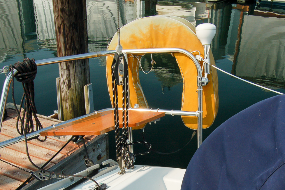

Hello,
I just bought a Beneteau 285 '89 and she has the split backstay with two blocks and a ring in the middle. There should be a 4 to 1 block setup with a cam cleat to increase mast tension I think but it didnt come with anything. I'd like to know what others have setup and or any advice. Line size. Block size. For example can a smaller dingy 4 to 1 block set be use since it's not under much tension. Or is there a totally different way that works? Pictures would also help.
Thanks in advance.
Nov 21, 2007
673
Congratulations on your First 285, and welcome to the Forum! The first boat that we purchased was a '90 First 285, and we loved it! I can provide the picture, but no specifics regarding line size or other details as that was handled by our previous owner. I do know that the blocks in this photo appear to be original era. I cropped the photo to focus on the adjuster itself. Good luck, and enjoy!

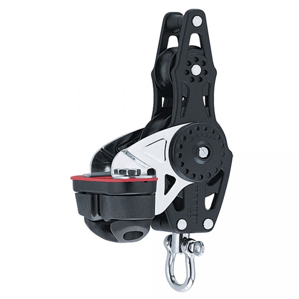

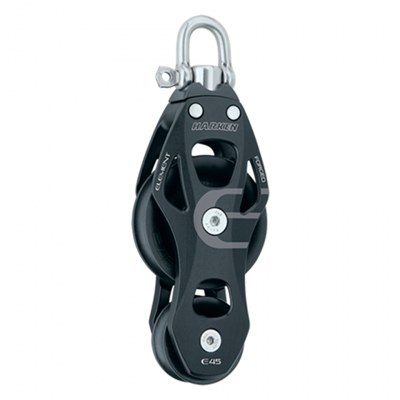

I suspect you are looking at a fiddle block for the upper and a fiddle block with a cam and becket for the lower.
Harken makes them in a 40mm, which would be more than strong enough for this task.
Line diameter would depend on the size of the sheaves in your blocks. I think 5/16 or 3/8 would be more than enough and would provide a good hand feel.
