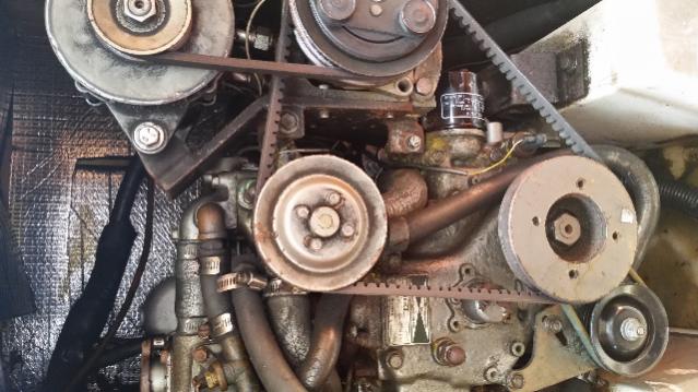

Does anyone have the info or a good link on what the exact sizes of all three (Alt, Water and main) belts are for the Yanmar3gm30f?

Strange - here are the three I have....
Sep 4, 2007
776
Hunter 33.5 Elbow, Saskatchwen, Can.
I would say that you have an A/C compressor that's not standard for the original engine. I like Dan's idea about just removing the belts and taking them to a parts store that sells gates belts. just my 2 cents worth.

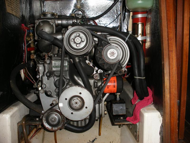

Oct 14, 2005
2,191
Here's...
the front view of the standard installation...
Looks like a GM AC compressor from the partial view...
Makes sense as I do have a frost box that runs off the engine - will measure and go to auto parts store - just want spares to be safe.
