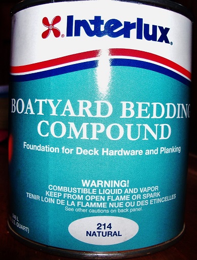

I've always used Bedding Compound for bedding deck hardware, stanchions and ports, etc. on any boat I've owned. Bedding compound was specifically designed for this purpose and I've never had it let me down.
You can spread it easily, even filling the bolt holes, as the clean up is with turps and a rag; very easy. It will not interfere when tightening the nuts on the bolts, or when it comes time to remove the item.
Many other products will do the job of course, but why not use the one product specifically designed for this purpose?
