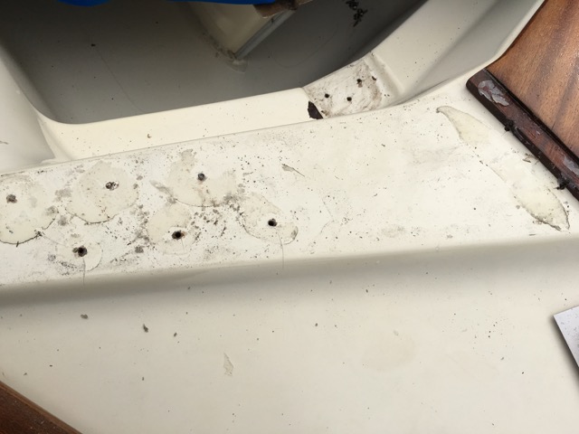

But now I have a bunch of screwed on fittings like bullseye fairleads, cam cleats, and wood trim. I have the holes in the glass countersunk. And I'm debating whether it would be better to put butyl on the screws and then screw the fittings down, or put Life Caulk on them. When I put on through bolted items, I can hold the bolt from spinning, so I know the butyl is mooshing in around the screw. But I'm concerned about the twisting of a screw pulling the butyl away from the screw and allowing leaks. I'm thinking a more liquid caulk like Life Caulk would be more tolerant of the spinning screw, especially with countersunk "reservoir" to hold material against the screw, and that once in place, the caulk would "flow" back around the fastener.

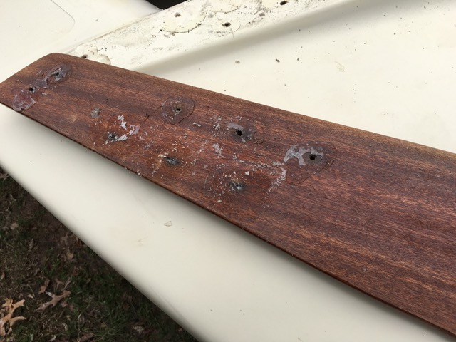

I will be putting a cone of tape around the fastener, under the fitting. So the fitting (or wood trim piece) will mush down on top of the glass, over the countersunk portion, goobing around the fastener.
I anticipate it will be far easier to remove the butyl tape next time I need to, say, varnish the splash boards. The previous owner didn't do a very good job of varnishing, and then he glued stuff down with clear silicone. To remove the splash boards, I basically had to shove a thin metal putty knife under them to cut the silicone. And, of course, the wood was contaminated under the inadequate amount of varnish, so fish eyes were legion. AUGH!!!!
