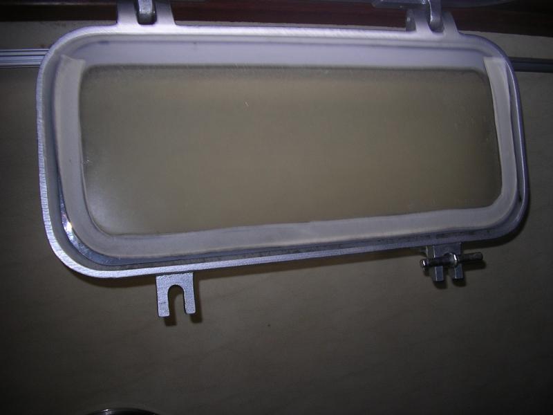

Here was my fix until I take time to change the gaskets.
I did this in Charleston two years ago and we've gone Maine to Miami since without any leaks.
