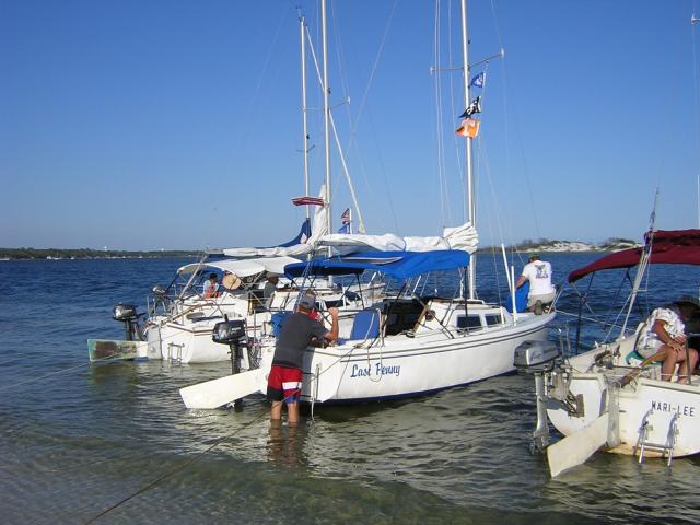

No problem!! We beach anchor ours all the time. While you can put the bow on the beach we prefer to toss a hook then back right up to the beach, toss another out. Your ladder will be the controlling factor, on mine I like it about 4 -10 inches from the bottom. This stops it from banging should there be any waves. (Before you start backing in loosen the rudder so it can be raised)
Watch the tides though or you'll be pushing the boat off the bottom. If you run your anchor line back to the winch, it's just a matter of loosing the stern hook then taking in the bow, slipping the boat off the beach. Make sure you raise the keel first, but should you forget trust me you won't be the first. Just take your time after a while you'll think nothing of it.:)
I meant to post this picture before but forgot. As you can see one can get quite close to the shore with no problems. Again if there is tides you'll want to keep an eye on them.

Thanks Ken !!!! Great info,very comforting!!!! Also nice picture.........We will try it very soon and let you know how it went. Arlene

Ken: That photo really is great.

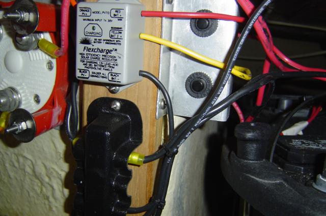

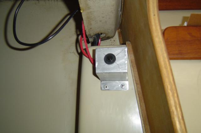

I used three breakers in place of fuses, I also needed a controller, with two batteries I needed one for dual batteries.

Ken: Thanks for your reply. I used to use a similar panel to charge my size 27 battery during the week, after cruising it on the weekends. I just laid the panel on the cockpit floor during the week, and put it in the car on the weekends. I also used a regulator similar to the one that you show.
As I said, my son wants to use this solar panel on top of his Bimini, so I will show him your photos. He also wants to use 2 batteries like you.
