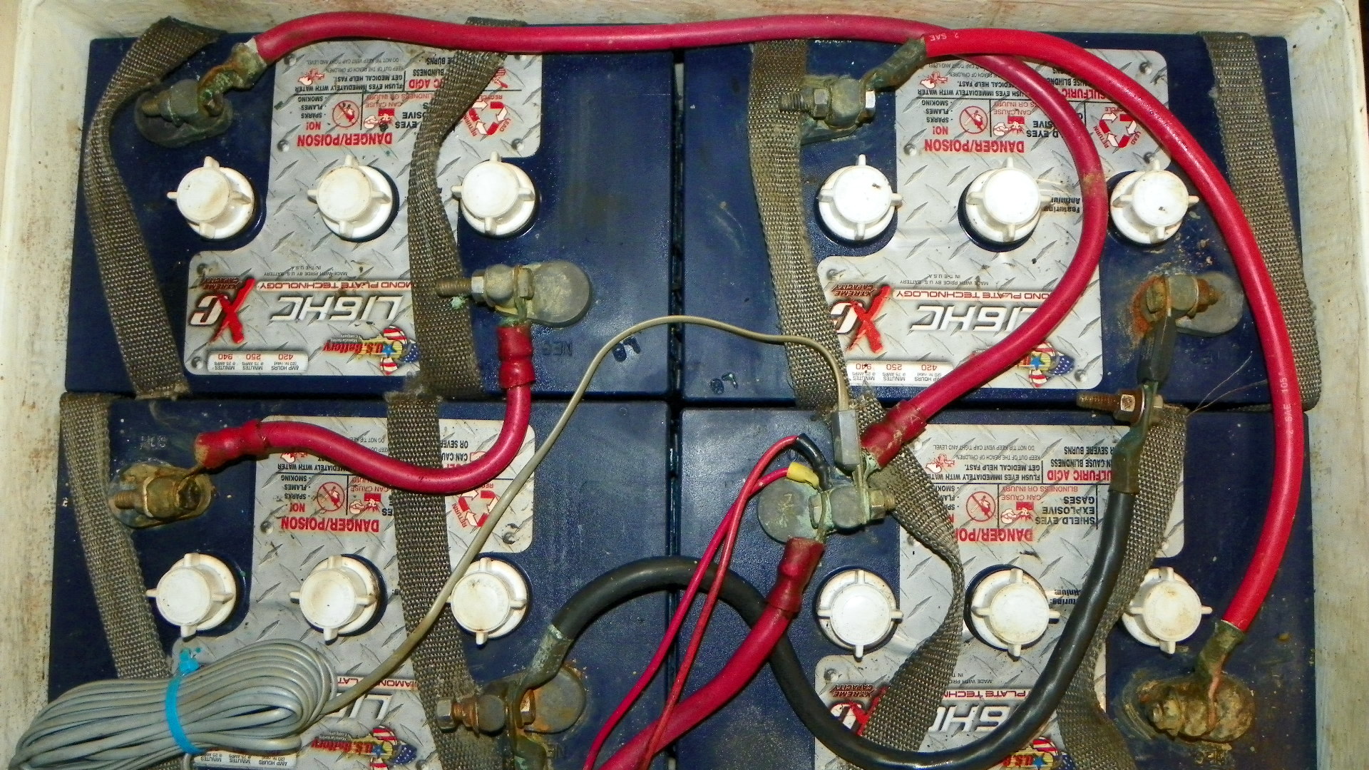

I installed new Deka L16 batteries (4x370AH, bank 740AH in April 2014. They
appear to be at the end of their lives at ~30 months in. We have been
diligent in keeping them watered with distilled water, and have battery
saver caps to minimize water loss.
We charge with a Honda 2000 connected to our shore power, which feeds a
Xantrex 70A/1500W temperature-probed inverter-charger. That has a design
issue which makes it not float out well, so we transfer to our 40A
stand-alone charger for the last of it.
We monitor everything through a Trimetric battery monitor. We fully charge
once a week or more often, through, also, our 370W solar feeding a Blue Sky
6024H MPPT controller, and our KISS wind generator, and equalize once a
month (using the Honda and the Xantrex).
When we're motoring, our alternator keeps up with it, but doesn't seem to
have a good control/regulator; even though the output shows low net incoming
amps after a long while, our cumulative AH shows positive values (20-40AH
typical) which, of course, goes away the moment the engine is off, but our
battery is certainly fully charged, if not equalized.
All charge sources are fed to a single buss protected by a 500A in-line
fuse. Our typical charge is at 25-30% discharged, so the battery doesn't
work very hard. It has been to 45% discharged a few times, and once to 55%
(Hurricane Matthew, with the KISS disabled, and not much sun in the 4 days
we were off the boat).
In the last few weeks, I have gotten up in the morning to ~220AH used - less
than 30% discharged - and found voltage at 11.3. Not good at all - whassup?
So, I've been wrestling, with no solutions or even clues.
We've been fully charging about every 2-3 days of late, due to work we've
been doing which requires the Honda, and yesterday I fully charged (one hour
at 14.1V or better) and equalized (2 hours at 15.2V or better), and
immediately read the batteries with a temperature-compensated hydrometer and
also our voltmeter, at the end, while still charging, the individual battery
voltages (ya, I know - they weren't disconnected).
The 4 had divergent readings at the end of the equalization cycle: 8.0,
7.3, 7.33 and 6.68 volts. The banks/pairs are 1/4 and 2/3, and,
cumulatively, the banks had the same readings, but with very different
single readings. I suppose that could be laid to the fact that I couldn't
effectively disconnect them, but it's still pretty weird...
Temperatures were very different between banks one and two (read down each
water-fill hole; I've averaged the 3 readings per battery) immediately after
equalization:75, 98, 100, 73F - from which I gather/intuit that bank one
(1/4) got much less amperage, somehow, or there was some problem in bank 2.
Specific gravities were lousy. All the cells read in about the same range
per battery, with bank 1 faring much better than bank 2: Bank one averaged
about 1.227 and bank two, temp compensated for 8-10 added, averaged 1.220 -
but that included one cell in 2/3 - at both ends; cells 5-8 read 1.220, but
had 1.235 and 1.260 in cells 4 and 9.
None of them was better than fair, and many of the cells were in the edge of
the "charge" range - immediately after equalizing.
So, clearly, something is amiss.
Beyond just bad luck, are there any ideas of how this might have occurred,
given the above? And, my presumption, are these batteries toast?
Thanks.
Skip

skipgundlach;3763306 said:
I installed new Deka L16 batteries (4x370AH, bank 740AH in April 2014. They appear to be at the end of their lives at ~30 months in.
Were the batteries ever commission charged? For batteries that are to be wired series or series>parallel I wire them in parallel then charge to 7.4V and about 0.5% or less of tail current base on the 20 hour capacity. The batteries are now "balanced" and can now be wired series>parallel. Batteries wired in series will have a very tough time "self balancing". If they are not in good balance one battery can easily become over charged while the other gets chronically undercharged....
We charge with a Honda 2000 connected to our shore power, which feeds a Xantrex 70A/1500W temperature-probed inverter-charger. That has a design issue which makes it not float out well, so we transfer to our 40A stand-alone charger for the last of it.
I am assuming by the term "charge" you are referring to bulk-charging In order to "charge" (fully charge) L-16's is going to take upwards of 8-12 hours with good equipment and correct voltages, and even longer with sub-par equipment.
We monitor everything through a Trimetric battery monitor. We fully charge once a week or more often, through, also, our 370W solar feeding a Blue Sky 6024H MPPT controller, and our KISS wind generator, and equalize once a month (using the Honda and the Xantrex).
I suspect you are putting WAY too much trust in your Ah counter. When was the last time you conducted a 20 hour capacity test and re-programmed the Trimetric for the banks actual capacity?
How are you defining "full"? Until your bank is accepting approx 0.5% of Ah capacity in charge current, at 14.7V to 14.8V, its simply not full. Many battery monitors attempt to re-set at 2% but again this is not a full battery and you're leaving sulfate on the plates.
Keeping Your Battery Monitor More Accurate (LINK)
When we're motoring, our alternator keeps up with it, but doesn't seem to have a good control/regulator; even though the output shows low net incoming amps after a long while, our cumulative AH shows positive values (20-40AH typical) which, of course, goes away the moment the engine is off, but our battery is certainly fully charged, if not equalized.
GIGO data (garbage in>garbage out) is simply unacceptable data to use. Unless your Trimetric has been painstakingly programmed and reset to 100% SOC when the batteries are actually at 100% SOC this data can be extremely misleading. The only reliable & repeatable way to determine full, on a cruising boat, is to hold absorption voltage (14.7V to 14.8V) until the net accepted current falls to approx 0.5% of bank Ah capacity or less.
Our typical charge is at 25-30% discharged, so the battery doesn't work very hard. It has been to 45% discharged a few times, and once to 55% (Hurricane Matthew, with the KISS disabled, and not much sun in the 4 days we were off the boat).
If the battery is left sulfated from chronic under charging it is still being worked hard. Shallow cycles are certainly much better for it, less sulfation created during discharge, but full charges must be attained as often as is humanly possible otherwise you will continually "walk down" the usable capacity due to PSOC (partial state of charge) use.. Low charging voltages, which can be a volt sensing issue, inadequate voltage regulation settings or alternators that reduce voltage as they heat up, and inadequate absorption duration are the two biggest hurdles most boaters deal with.
If you are only cycling to 70% SOC then you are also playing in the most charge inefficient range of the battery so your absorption voltage duration is absolutely critical in order to reach 100% SOC..
You will need to figure the correct duration out for your use and bank via SG or tail current @ absorption voltage. For a bank like that it will typically require 4-6+ hours of absorption, once absorption voltage has been attained, before float kicks in. If your charge sources do not allow an adjustment of the absorption duration, and far too many are absurdly short 1 hour or 2 hour egg-timers, then you'll want better charge equipment. For a live aboard cruiser solar simply disable float or set it to at least 14.3V with absorption being 14.7V+. If you leave the boat for extended periods re-set the float voltage.
In the last few weeks, I have gotten up in the morning to ~220AH used - less than 30% discharged - and found voltage at 11.3.
Based on what you've given us, it's pretty safe to say your bank has nowhere near the capacity that you have programmed into the monitor. Like many boaters with Ah counters you've put far too much trust in the Ah counter predicting SOC and too little attention to actual battery voltage..
This is not just for you but for all boaters.
DO NOT REGULARLY DISCHARGE BELOW 12.2V EVEN UNDER LIVE AVERAGE HOUSE LOADS
Sure on a long passage it is okay to dip towards 11.7V, but if this basic premise had been followed you'd have very quickly realized the bank was walking down in capacity and the Trimetric was fooling you. A bottom voltage is the best thing any boater with an Ah counter can incorporate. You can even set an alarm for 12.2V...
We've been fully charging about every 2-3 days yesterday I fully charged (one hour at 14.1V or better) and equalized (2 hours at 15.2V or better),
Three hours of absorption is not full and 14.1V spells murder for L-16's.....
The 4 had divergent readings at the end of the equalization cycle: 8.0,7.3, 7.33 and 6.68 volts. The banks/pairs are 1/4 and 2/3,
Not really that weird they have been under charged, likely not properly commission charged, and they have become out of balance or started life out of balance and this just got worse. This could also be due to bank interconnect wiring or trying to alternate two house banks instead of one large contiguous bank... I also have no idea what you mean by "The banks/pairs are 1/4 and 2/3,"?
Temperatures were very different between banks one and two immediately after equalization:75, 98, 100, 73F
You had one out of balance battery being pushed to 8V, and this is the equivalent of 16V, while another battery was at 6.68V which is the equivalent of 13.36V.. The bank is severely out of balance.
Put another way you have two batteries in series that have become out of balance and they look like this during charging.
Battery #1 = 8V
Battery #2 = 6.68V
Charger See's = 14.68V
Battery #1 - Being grossly over charged
Battery #2 - Being grossly under charged
Sounds like chronic under charging & sulfation...
None of them was better than fair, and many of the cells were in the edge of the "charge" range - immediately after equalizing.
I have an idea yes but we really need more information on equipment, wiring, bank use, bank wiring, alternator model and amp rating, Blue Sky settings etc....
The batteries may be toast but may recover to a suitable & still usable smaller size too. Best to conduct a 20 hour test to see where they stand. 370Ah / 20 = 18.5A constant load for a capacity test to a 10.5V cut off. If the battery only runs a fraction of 20 hours this will be the percentage in-hours, of the 20 hour rating. For example if the battery only runs for 10 hours to 10.5V at 18.5A and at 75-80F, then the bank is at 50% of its rated capacity and is pretty much done for. If it runs for 16 hours you're at 80% of rating and the bank is starting to approach the danger zone...[/quote]

My apologies for not having come back on these comments. I don't seem to have a notification setting and didn't know about them until I was posting our findings.
I'll come back in a bit and address them. Lots of good stuff...

Thanks for the comprehensive reply. I've been - suggested in another thread elsewhere - to your site and read a bit about your battery info...
Unfortunately, I don't know how to make my comments, to which you responded, show up also, but...
[/QUOTE]
They came new from the factory; I questioned their state of charge at the time, but charged them initially. Based on what I've been reading, they might never have actually been fully charged. I even had the tech out again later, but he pronounced them all 'good' and as expected, including load testing.
I have not yet decided what I'll do about a replacement, but if it's not locally sourced, getting them fully charged may be an issue. And, the local (St. Lucie Tire and Battery) outfit which provided them may not even have the right gear to do that (being 6V)...
[/QUOTE]
Heh. Perhaps. But I nearly always was charging in the low-200s AH down, or 75-80% SOC. OTOH, based on what I've been reading, I agree with your assessment about time required being dramatically longer. A new inverter-charger may be in the offing, but it's frustrating, as we next to never use the inverter, and when we do, the 1500w is more than ample; a larger charger would come with a much larger inverter potential, at presumed significantly larger cost.
[/QUOTE]
Probably no surprise, but so far as I can tell, never, and we've not been ratcheting down the bank size, either. I read your piece on controllers, so know that it's strictly a crapshoot as to what lower settings I should be programming, in what time periods.
So, we'll be doing our best to keep up with that moving forward.

I couldn't figure out how to post a pic of how our cabling is set up, but the 4 L16 I designate as 1,2,3,4, with those being port aft, port forward, starboard forward and starboard aft, in that order, and I count (identify) cells in the same fashion when I'm doing a SGR. So, if I consider 1&4 batteries as 'bank 1' and 2&3 batteries as 'bank 2' I can identify the two 12V pairs which parallel (one house bank only) to make my 740AH house bank.
The cables are all substantial (0, I think), but are not the same inch length. There's one pair-link which is only 8" or so, and the longest might be 2' for the parallel link, with the rest being mostly shorter, somewhat. Would that little a discrepancy be significant?
Battery #1 = 8V
Battery #2 = 6.68V

I hope you've corrected the deficiencies in that wiring since that pic was taken...
Incorrect use of a fuse (needs to be in a fuse holder)
Incorrect location for a fuse (should be in + conductor)
Incorrect fuse type (should be ANL, Class T or MRBF to meet AIC requirements)
Incorrect location for a temp sensor (can not be on positive terminal and can not be between lug and terminal)
Incorrect lug stacking (highest amperage lug is always on the bottom)
Unequal series & parallel wiring lengths (in order to keep batteries balanced wiring should be as short as possible and equal as close to equal lengths as possible)
Massive amounts of corrosion
Open lugs with no adhesive heat shrink or even tape
Possible ferrous nuts or washers resulting in rust
Positive & negative wires physically crossing/laying on one another
2GA high amperage wiring is marginal at best for a 46 footer especially one with an inverter or windlass. A Xantrex 1500W inverter requires 1/0 wiring for a 1-3 foot circuit and 2/0 for a circuit of 6-10 feet (round trip)..
Jan 2, 2007
131
Morgan 461 St. Thomas
As below:
The fuse was removed; all leads now on single buss-type fuse with terminal posts and cover for 500A fuse ANL type
The temp sensor was removed during our current bank installation, and was put between the batteries; is that appropriate?
I'm unfamiliar with the term (lug stacking), nor how to determine highest amperage lug. Assuming that our replacements likely will be the same (US L16HC-XC2) but now with L lugs, and that we're limited to that real estate, how would you cable this? The positive and negative leads are the only ones leaving the bank (though the PowerPulse connections might be on the terminals in the current installation; I forget)...
Ah. That answered one of my questions. Even though the difference is a matter of inches, that's a significant event in the health of the bank?
The current installation is pristine. And frustrating, because physically, until I discovered the bulge on the left side of the top right battery (again, the pic is of the installation preceding the current one), they looked like new.
Hm. Aside from that being a trivial remedy (I have it in hand, and will do that with whatever cabling goes in the new bank), what's the significance here, in an isolated environment (strapped lid on secure box)?
These are SS hardware, 1/4x20 bolts, nuts and washers, currently; I think they were in the pic, too, but as noted, it was lousy in that picture.
Ah. I wasn't aware (nor were any of the marine electricians who were responsible for the installations so far) that was an issue. As above, how would you cable this installation, both to remedy previous and this issue?
Each leg is probably 3' or so; I don't know the gauge, but it's very substantial.
However, that brings another - probably expen$ive - question; given a Honda 2000 as the typical available 'shore power' what is the best inverter-charger to replace this likely-inaccurate/aging 1500/70? Or, if the real estate were available, maybe a stand-alone for each? Our inverter-alone loads are very infrequent, and are used for operating either a Stinger mini-shopvac or our heat gun for defrosting, or, even more rarely, perhaps a 60w soldering iron, so a larger-capacity inverter/charger would likely have a severe overhead redundancy in the inverter portion. We mostly have the Honda running whenever we use one of these, anyway, so COULD manage without an inverter, I suppose.
Thanks for your erudition and depth. Maybe it's possible to teach an old (72) dog new tricks...
L8R
Skip
