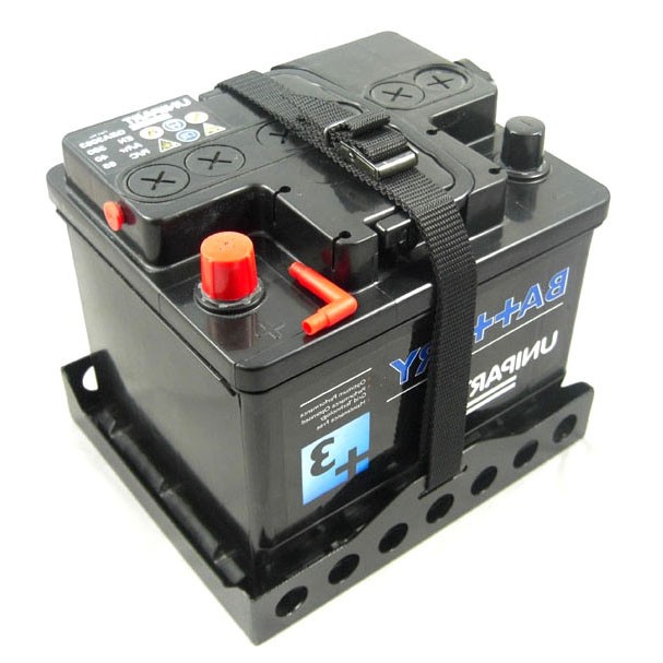

@marchem Here is one idea.
You would need to screw down the base. Then strap the batteries.
I have also used wood strip across the top and locked down the sides. That may also work in confined space. That is what I am doing.

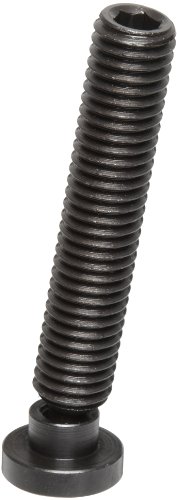

How about something like a tapped or insert thread through the pan sidewalls and a set screw with a pad. You tighten it against the side of your battery to lock it in place.
Don't know what space is accessible or how much room that pan provides to your battery, but I can picture a number of slick options, straps probably being the easiest. If you're worried about terminal and cap access, think about a way to lock the batteries in from the side.

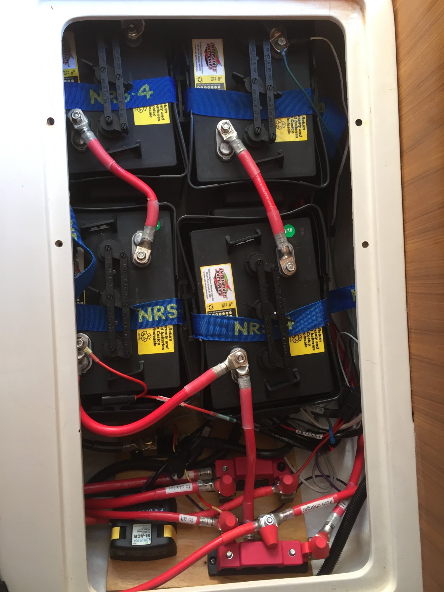

For strapping multiple batteries with one strap see below. Note how the strap dips down between batteries to yield a sturdy support for each battery without "pinching" them together. *These are AGM batteries using "mounting trays", flooded batteries would require acid containment & the "trays", really boxes, would need to be as tall as the battery... With these straps cinched down tight into the trays these batteries have less than 1mm of wiggle room....
These NRS straps are 1.5" wide polypropylene and nearly bomb proof especially compared to the cheesy battery straps with plastic buckles that ship with those black plastic battery boxes. If I had a dime for ever cracked or broken plastic buckle on battery box straps I've seen, I'd be retired on a beach right now sipping a Margarita... The machine screws are through bolted..

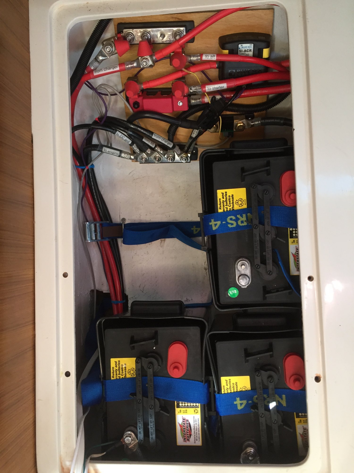

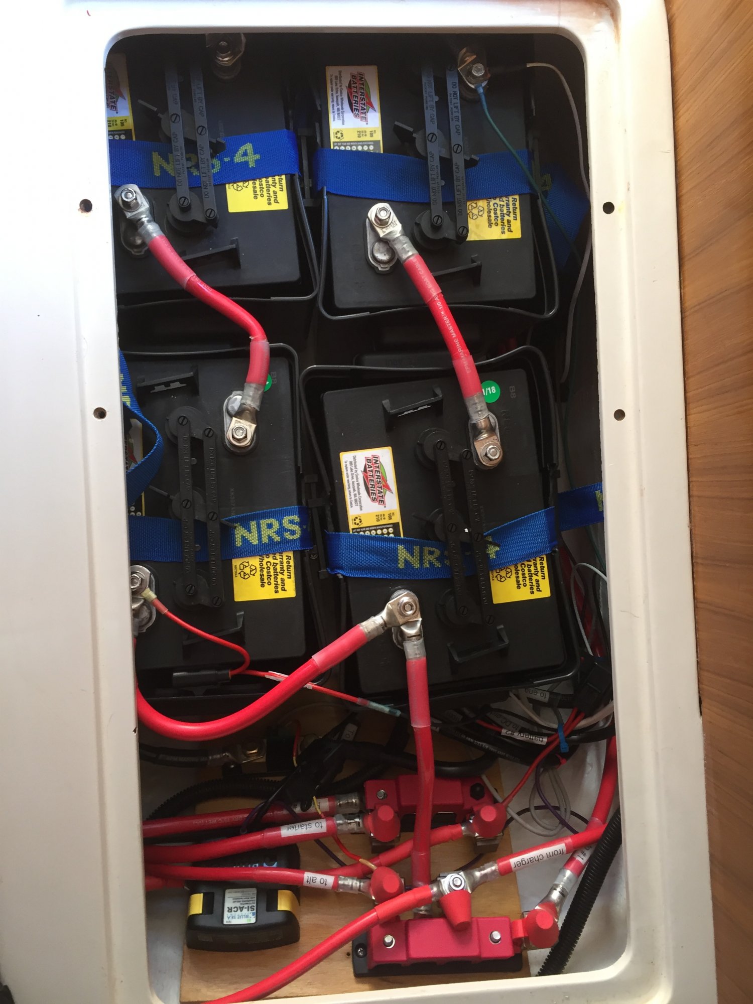

Ended up going with GC2 battery boxes (Batteries and Bulbs had them locally) and NRS straps. Screwed the strap holders into the shelf. The boxes are a little distorted, but they don't move at all. Later I added a watering system, because it's real hard to get to them otherwise. I put the starter battery (G24 size) under the port settee, in it's own box.
I'd make sure there is a vent in the settee space so that it can vent.

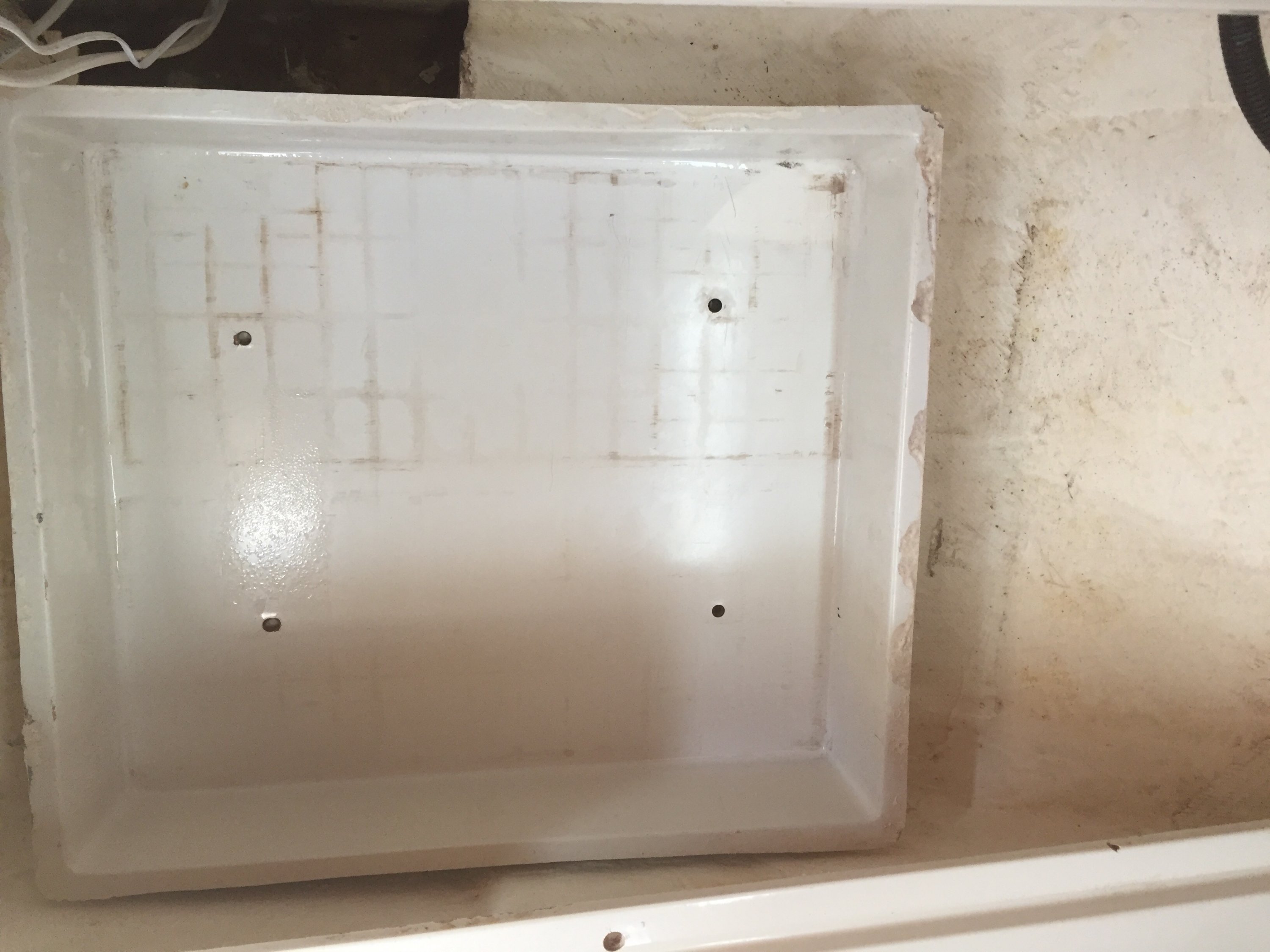

When I removed the pair of 4D batteries, they were not in a battery box. I think the tray that is under the batteries is intended to be the containment area. Can anyone verify this? The tray is shown in post #5.

Are they flooded leas acid batteries, DJ. If so, you really should have traditional boxes that have deeper containers with suffice to volume to contain the acid.
dj
That was the tray the batteries were sitting in. The holes in the bottom, not to mention the small volume, made it less than effective for containment. That’s why I used battery boxes for the new batteries.
