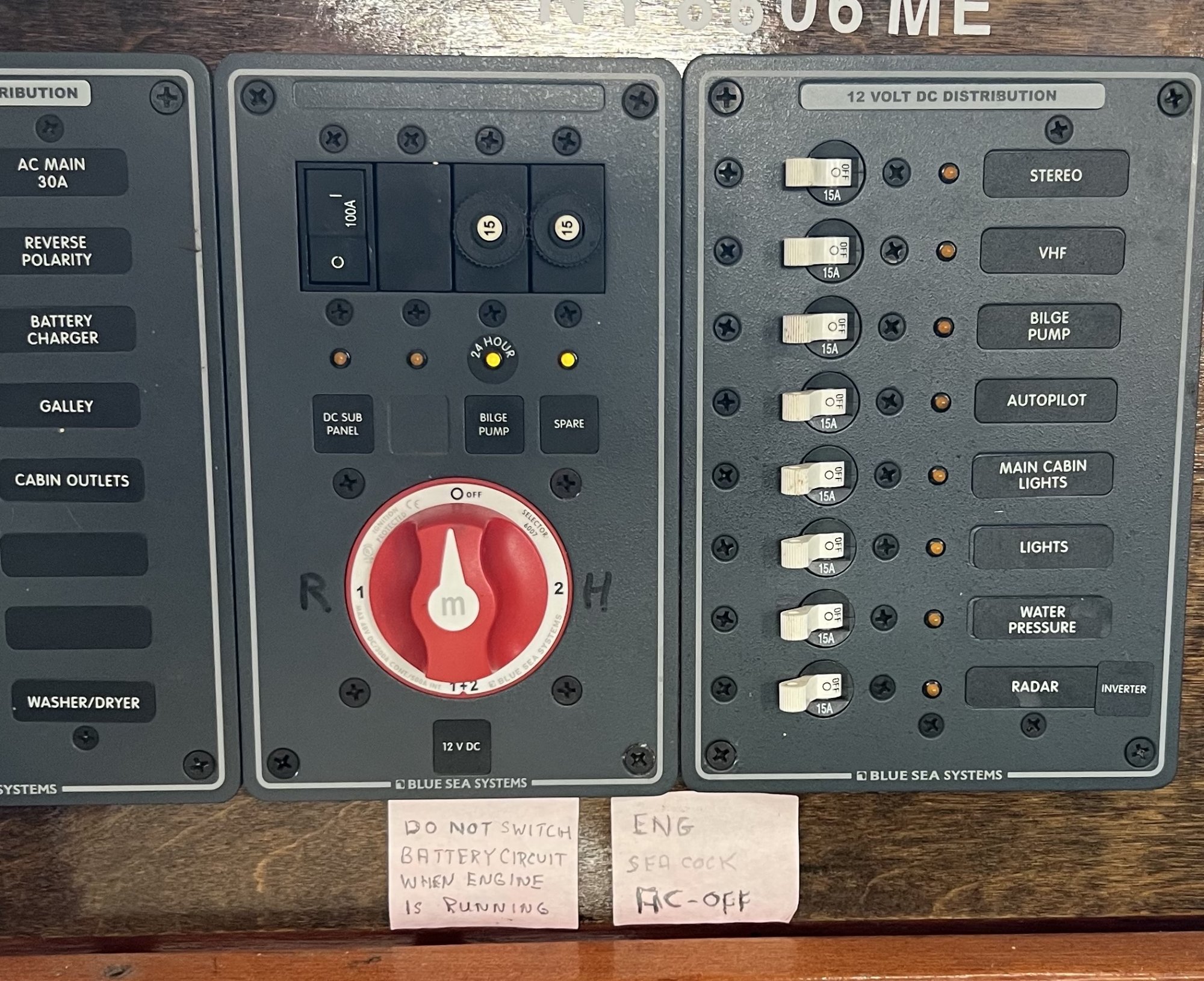

Hi All!
Picking up our "new to us" C-30 on Tuesday (thanks to everyone that chimed in on my prop question last week) and would appreciate a little feedback on a piece of information I got from the P.O... He's suggesting that we should NOT switch the Battery from Run / 1 to 1+2 while the engine is running. His concern is that the Alternator will spike and that could cause damage in the time the switch travels from 1 -> 1+2. He even put a sticky below the switch to help prevent this action.
If this is the case, I do not see how anyone could charge the house batteries via the alternator. And, I've never heard of a disconnected alternator being damaged when an engine is running.
Wondering if this is born of an abundance of caution and perhaps a known issue?
Thoughts? Thanks!

The 6007 is a “make before break” switch. That means switching from 1 to 1+2 makes the connection to 2 without breaking the connection to 1. Definitely do NOT switch to Off while the engine is running. That does risk a voltage spike which could blow the diodes in the alternator.
Specs for that switch are at https://www.bluesea.com/products/6007/m-Series_Mini_Selector_Battery_Switch_-_Red
A really good article about the various considerations of the 1-2-B switch is at 1/2/BOTH Switch Considerations

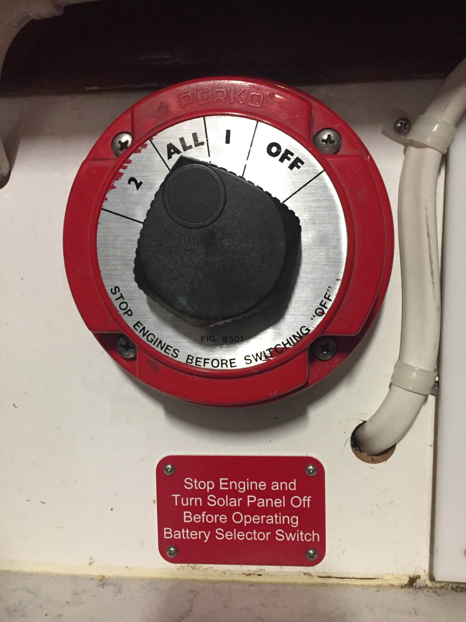

As you can see there is a warning right on this switch to stop engine before switching off. The reason for this is the voltage spike that comes when a current carrying inductor is open circuited. The solar controller is now an additional device that has an inductor in it, hence the added requirement that the panel be switched off.
I know that the switch is a make before break and therefore switching between 1/ALL/2 should not result in a problem, however
1 If the wiping action results in a momentary break or
2 If someone misoperates the switch
you just scored an own goal, so I have laid down the rule - no changes unless panel and engine are off.
