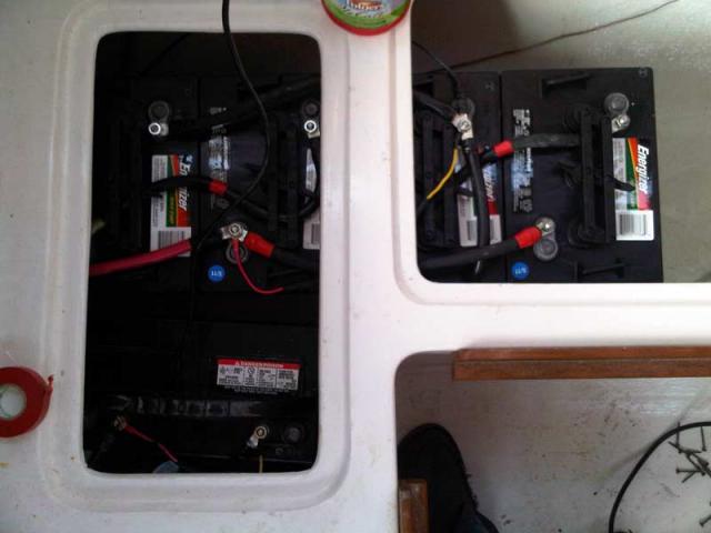

I put in 4 6v golf cart batteries for starting and house, and 1 group 27 as backup. Might be an overkill but I get about 450Ah's from the 6v bank. I'll be able to play music allllll day long.

It's set up as 1 bank of 4 6v batteries and then the group 27 is bank 2 (I suppose) and only used for emergencies. Both banks are hooked up to a dual charger when at the dock. A VSR relay charges both banks while the engine is running and prevents over charging as well.
Bank 1 (the 6v's) are wired to position 1 on my battery switch. They are used for starting and house loads. There are two groups of two batteries within Bank 1. Each group has two 6v batteries connected in Series...this doubles the voltage to 12v. Then the two groups are connected in Parallel...this doubles the Amps.

SWG, Your explanation is fine..makes sense to me, but that is a LOT of amp hours you have there! :eek:

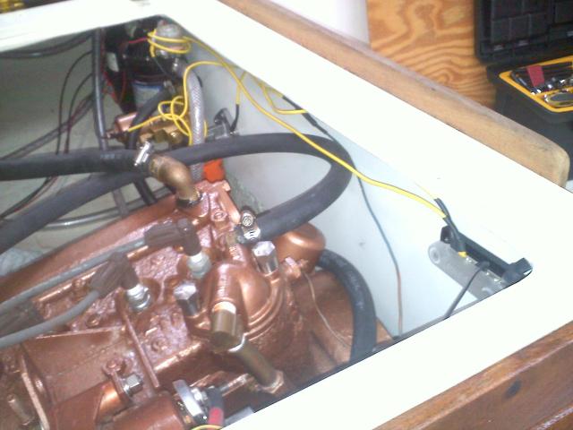

And the port side set up sounds about right..Mine is a 1977, and I only have the single 17 gal. water tank on the stbd side & the two holes in the hull for the head lines in the forward half of the port settee. A couple years later, Catalina started putting a 17 gal tank in the port settee and made it for black water, right in the same spot where your batteries are, which is why I was asking.
I've moved my batteries over to the stbd settee, and eventually plan to add the 2nd 17 gal. tank to port for more fresh water (I built a custom v-berth tank modeled after the Catalina design as the holding tank since it is 25 gal.)
In the area where the batteries were on our boat originally, I mounted a large piece of PVC board using the existing long bolts that hold the table support (if you make the dinette into a bed.) This makes it real easy to mount stuff and move it around without drilling additional holes in the fiberglass (of which the P.O. already had made plenty.) Now, I have the oil filter & fresh water pump there, and eventually will mount the HX & coolant resevoir when I get the time to convert the A4 to FWC.
I have a single Gr27 for house & a Gr24 for 'start/emergency', but I have modest electrical requirements...if I ever added something like a fridge or more power hungry electronics, I may need more Amp hours some day.
Always nice to see & discuss other setups to get some ideas. Thanks!
Here's a pic of that same area in my boat...the wiring job is a work in progress, so things are not all tidied up yet.
