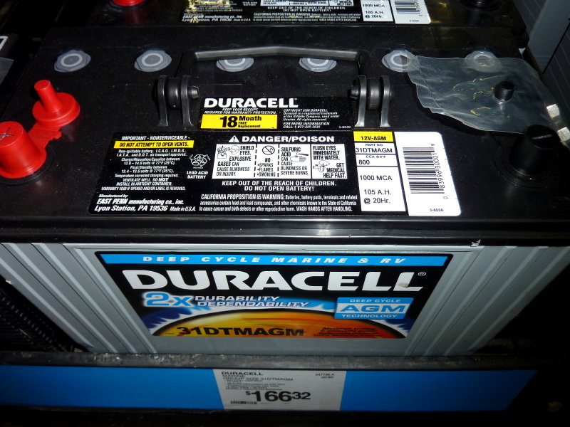

While all the above is true, I use the Duracell group 31s as pictured above from Sam's in my 1990 C30. $166 for AGM compared to $93 for regular. They fit in the space under the starboard settee nicely. I bought them about 2 years ago and haven't had any issues and it's nice not to have to check the electrolyte level. I also had 4 Odyssey's AGM group 31's in my electric powered C27. They were very expensive.
