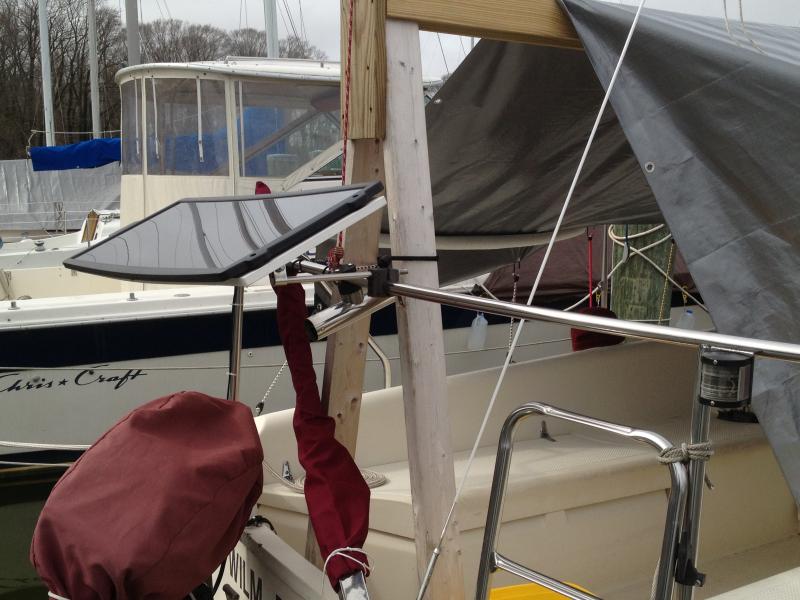

for the ultimate in reliability and dependability, install a 60 watt solar panel with a quality controller. it will work when you are away from shore power, so you are never without unless you have equipment failure...
once installed, you should reasonably expect 20+ years from it with very little maintenance.... and with the quality controller it will keep the battery properly charged, unlike many of the cheap float chargers that is on the market....
I have installed solar on my boat after using the charger for too long, and I have become a proponent for it due to the simplicity and dependability of the system...

a 60watt system will give you a dependable 2 amp charge minimum and will probably keep ahead of your highest demands for now, but if you do some research on actual installations that people have done, you may come to understand it better.
its almost an "install it and forget it" system, but you will still need to service your battery regularly.
of all the modifications and add-ons i have installed on my boat, the solar power system is by far the most useful.... it has taken the time, trouble and worry out of having a dead battery and the PITA of charging it back up....
