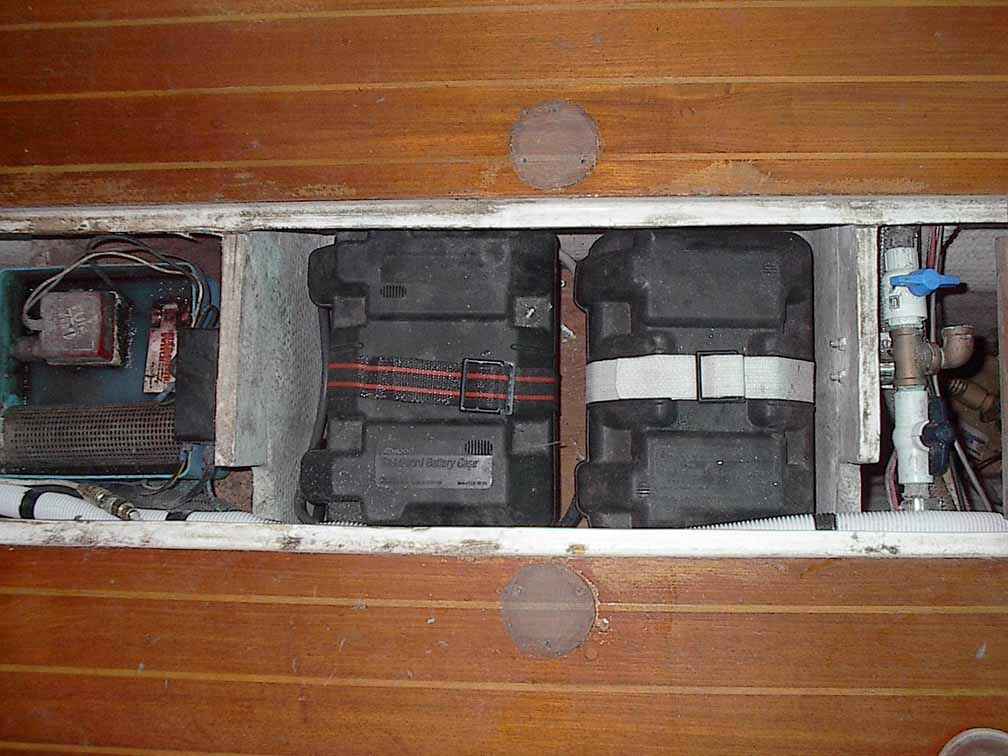

The attached picture shows the batteries as they were in 2000. The ice box is to the left (forward) of the batteries.

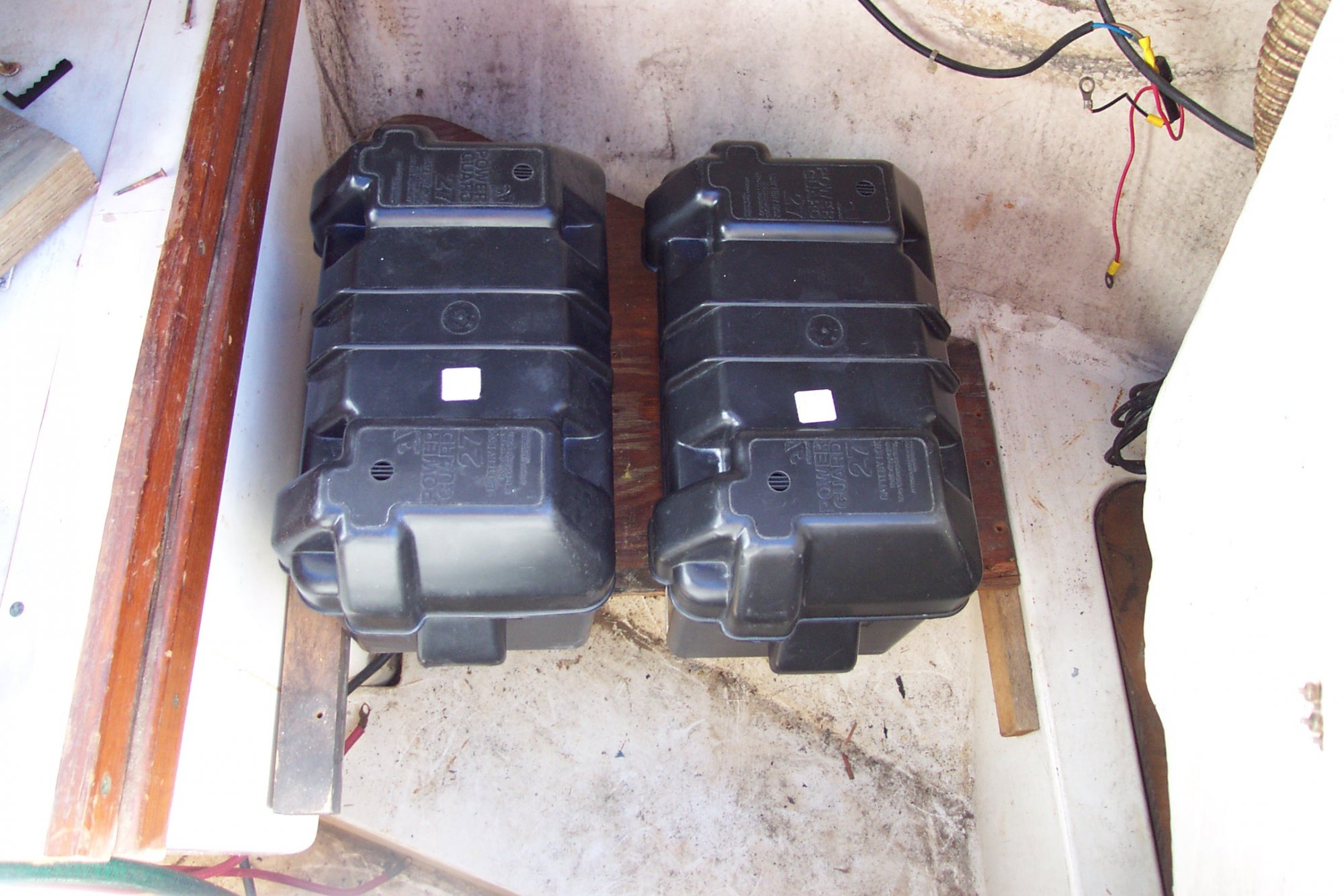

On my 37C I left one (starter) battery in the original starboard cockpit locker location and moved the house bank - 3 x Group 24 - to under the cabin sole. I just glassed a couple of shelves in. I understand that the bilge is deep enough for a couple of golf cart batteries; several owners converted to these. This picture shows 2 of 3 Group 24 batteries under the cabin sole. This is where you want the weight of heavy things like batteries - down low and centered.

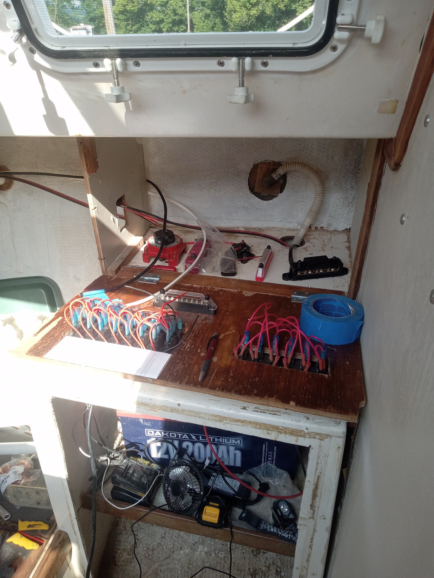

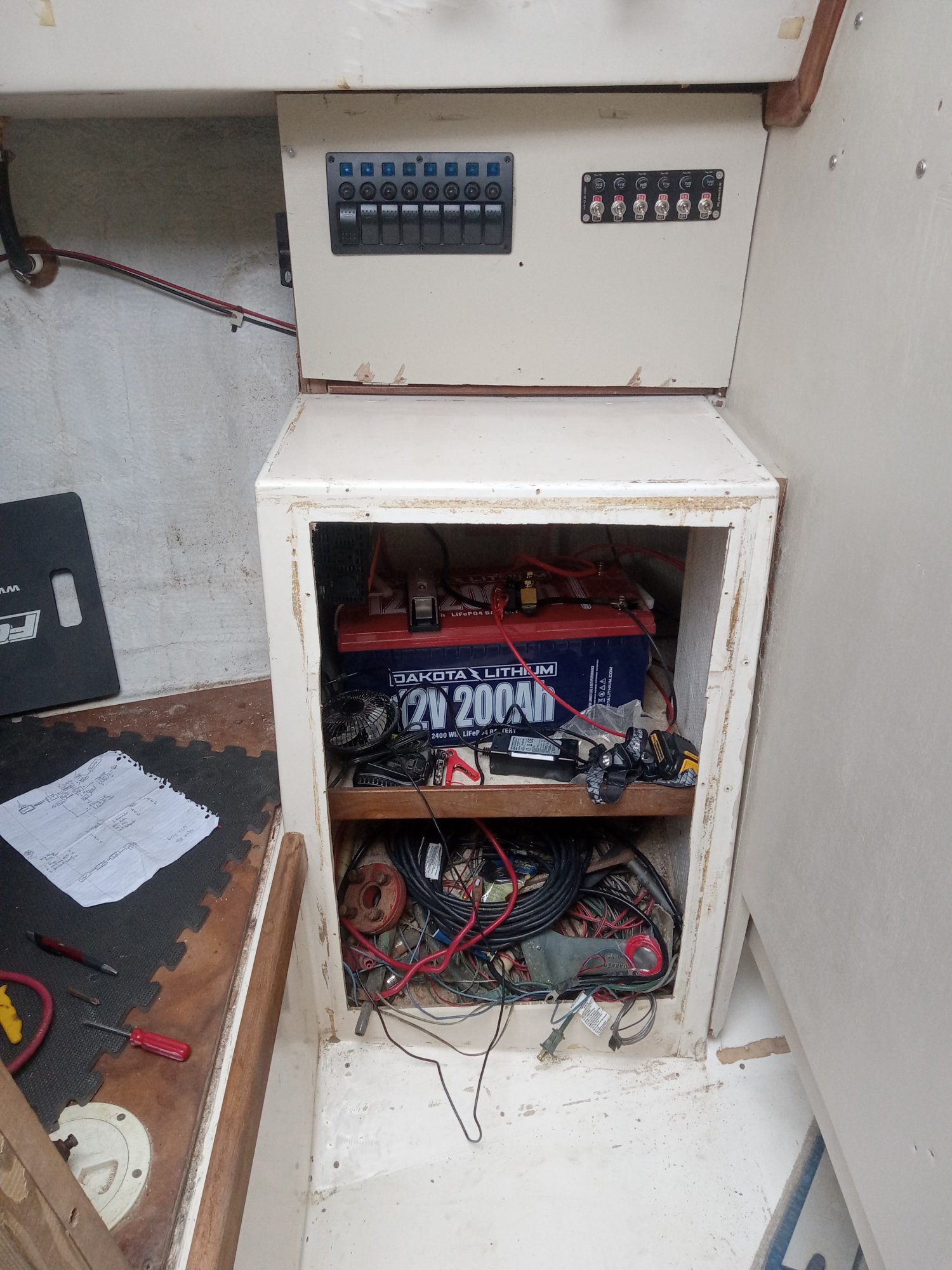

Completely rewiring my 37c. This is the 'doghouse'. Removed the water intake and glassed in the hole. So no leaks above this area. Creating a new switch panel and fitting my shunt, bus bars, fuses, and the panel can open down for access. Will fit a slotted door for airflow.
I think this will be pretty tidy and a good use of the space. Having the battery close to the panel makes for short heavy leads.
