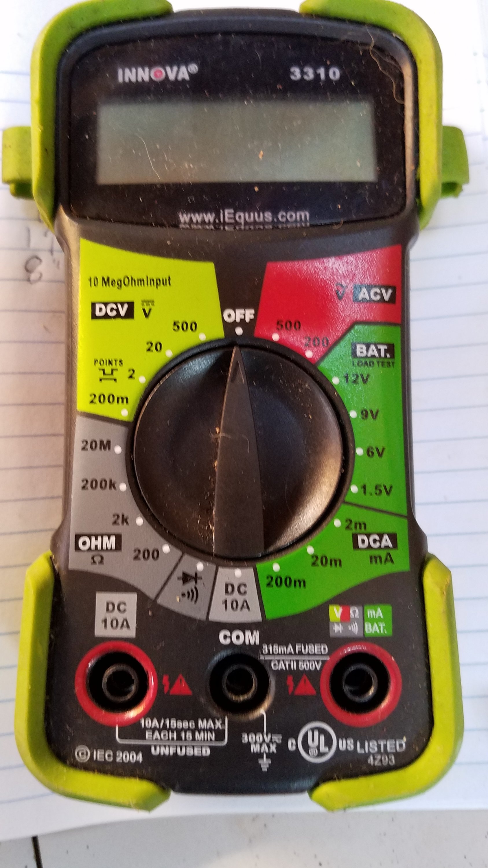

Finally, I tried to check voltages out with my voltage meter, but - I'm embarrassed to say - I really don't know how to use it properly, Here's a picture of the meter. Maybe somebody could tell me what settings I use for what and which terminals (on bottom of meter) I use for what. (I'm assuming the center - black - one is for the black/negative wire and the ones on either side are for the pos. wire, but which side I use for what I don't know.)
thanks in advance for your patience.

To use your meter to measure voltage you set the center dial to the 20 in the yellow area. This is for measuring DC Volts, up to 20 volts (you boat has a 12volt DC electrical system). You plug the black probe into the center COM plug and the red probe into the the plug on the right. Note that it has the yellow, red, green and dark gray print above it. The left plug is to measure AMPS (it's the same gray as the DC10A on the dial). Be sure to connect the black prove to the negative and red to the positive.
Some other notes for you: To measure AC volts (like you have at home or when connected to shore power) set the dial to the red 200 setting. If you want to check a lightbulb or for a broken wire use the gray setting just to the left of the DC10A. This is to measure resistance and it will beep if the light bulb or wire is good (connect the probe to both ends of a wire or to the + and 0 of the lightbulb.
