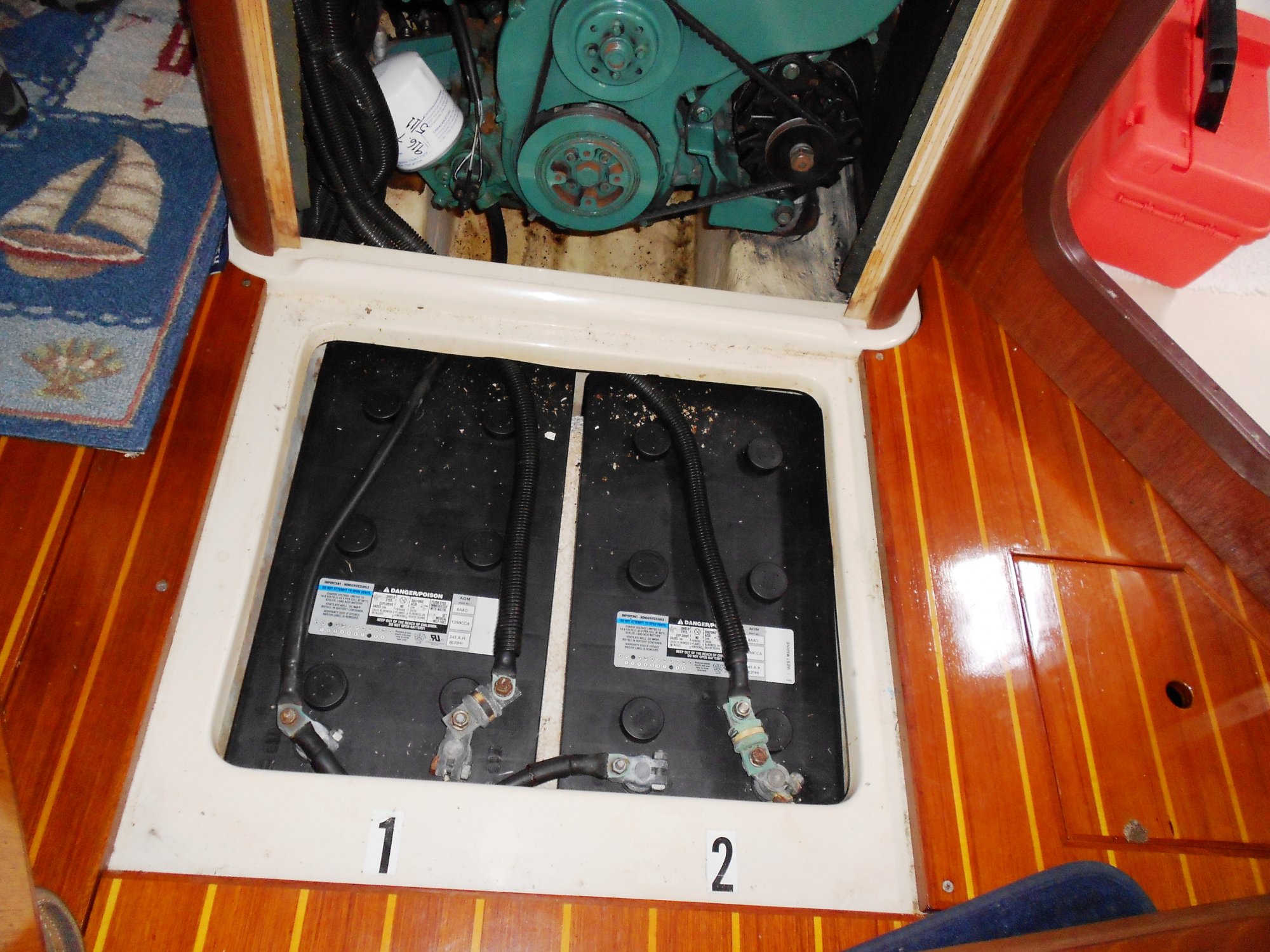

This is the "Broker" pictures 2012 of 2x8D by the Previous owner.
I now have 2x4D
I show this since the Engine and Batteries are aligned on the Centerline of the boat.
The plates will be exposed in heavy seas, no matter Port/Starboard.
But plate exposure is minimized.
Jim...
I now have 2x4D
Jim...
I think that is the proper orientation for 4Ds since the cells are aligned differently in 4ds
The 4D's and 8D's are the same cell alignment. Port/Starboard.
The Middle cell will stay flooded in Fore/Aft heavy seas.
