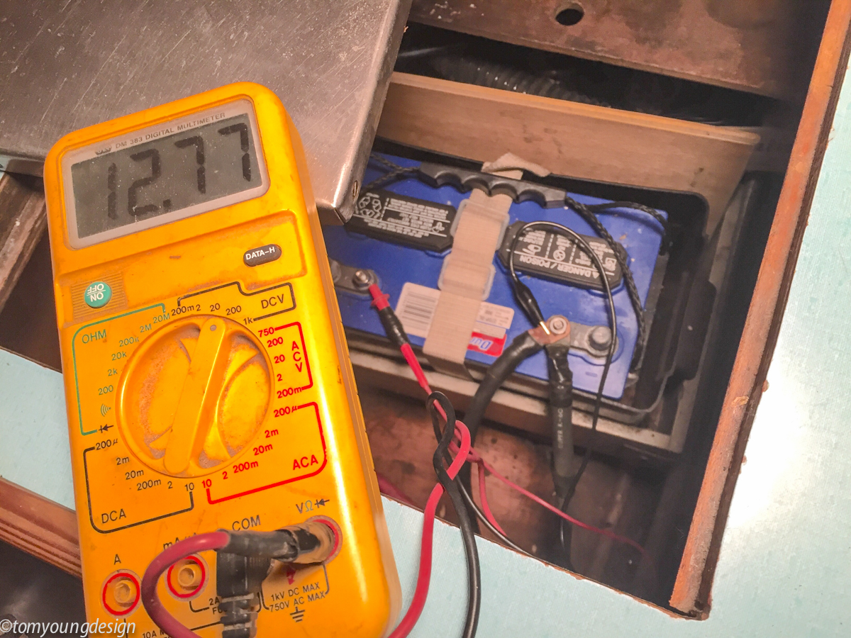

After 3 boats, I'm still using the same battery monitor (a simple 30 yr old digital voltage meter).
If your electrical needs are simple; i.e. you don't have refrigeration, you can treat your batteries very simply: Don't let them get thirsty or really dead.
To check state of charge, wait at least a day of rest (no charge-no discharge), for a digital reading.
In the fall, charge them fully, forget they exist, and check the voltage in the spring.
If they've lost more than 10-20% SOC, they're serving notice for replacement.
Good to go:
