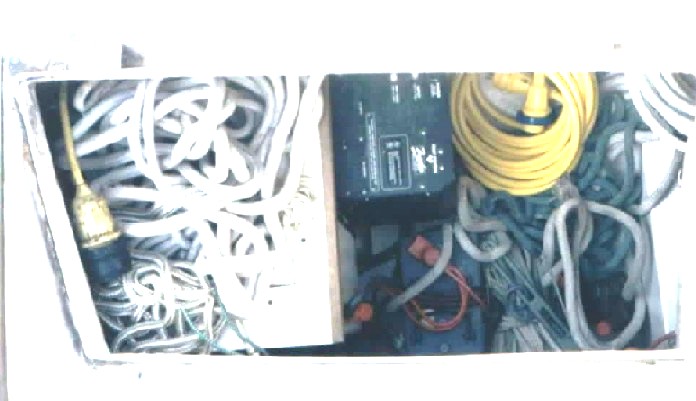

Hi Bob, I have seen some large batteries in the bilge of the H37C. Plenty of room, especially if you relocate the shower sump. I kept mine where yours are located. But I went with Gels when I bought the boat because I did not ever want to go back down there. Since then I have replaced the starter gel with an AGM. Then I added the starter gel to the house bank, now over 300 Ah with three gels. Two are on the hull under the icebox(one AGM, one Gel). The other two are on the shelf behihd the icebox. I wanted to keep the batteries there because all the #2 cables are shortest and my Link 2000 wiring and inverter/charger are all in there. The picture is before I added the third gel. It sits right beside the one you see there.
