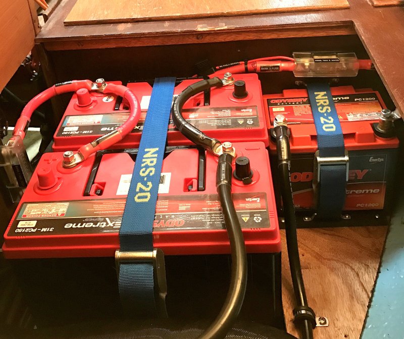

Most of the time I use NRS 1.5" Polypropylene hold down straps. Far better than those cheap battery straps and they can be cinched quite tightly. I use SS pad eyes that are through bolted for the straps...

MS, that's not a wooden shelf your batteries are resting on is it? ;)
Absolutely because those are TPPL AGM batteries which do not need acid containment like a flooded battery does.. This is one of the nice benefits of a "non-spillable" class AGM battery especially when dealing with tight spaces.
Oh and that teeny tiny TPPL AGM cranking battery will start the 38HP Westerbeke about 45 times before it needs a charge....;)
