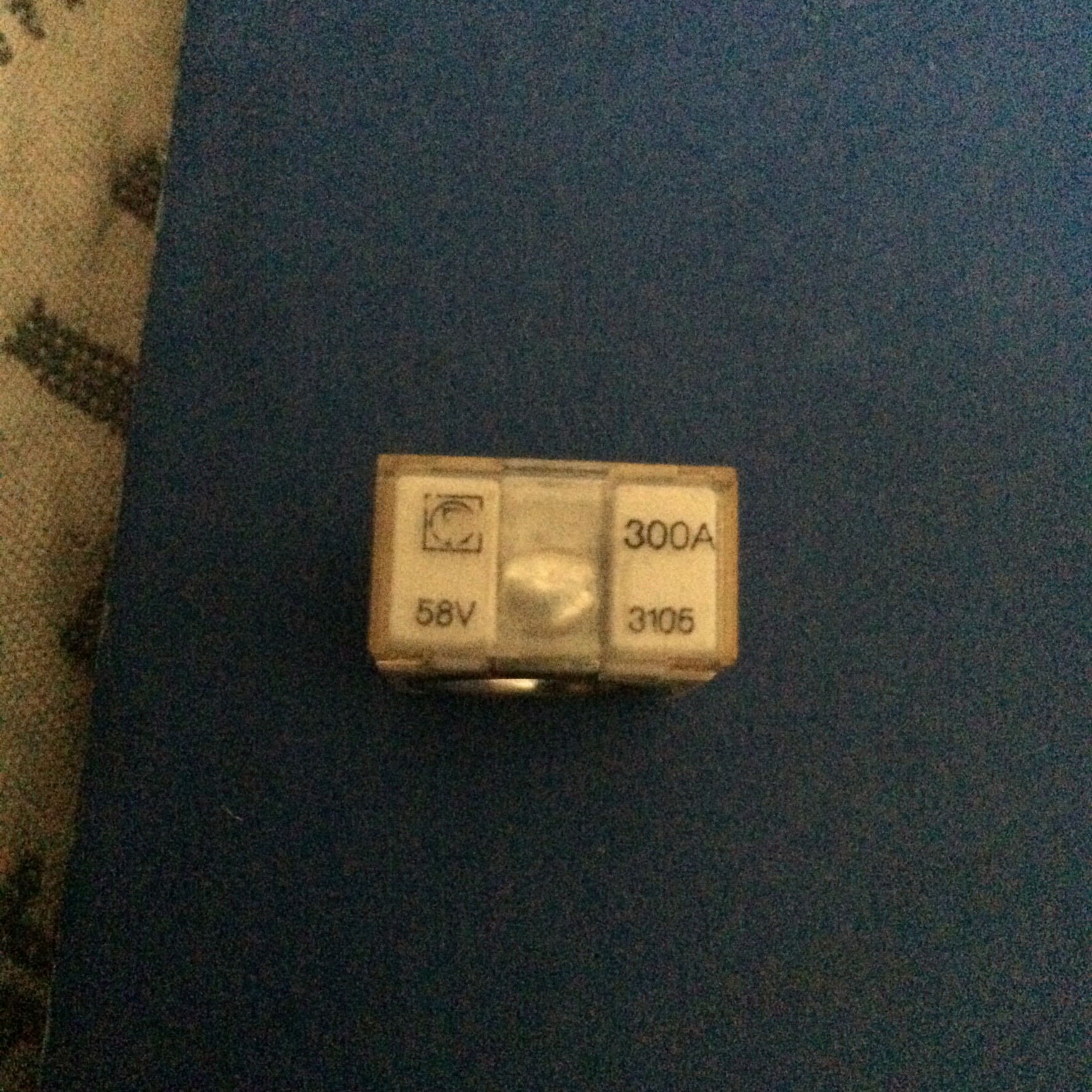

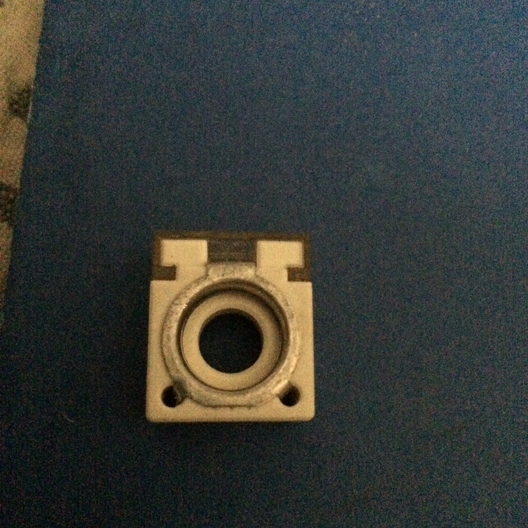

Sorry, been a while since I have been on the forum. This is a fuse on a positive battery post. What are they for and where can I get them?
Thanks
Jan 18, 2016
782
Catalina 387 Dana Point
Yup. MRBF fuses. Sold here at the link jssailem posted. West generally has em if you need them right away.
