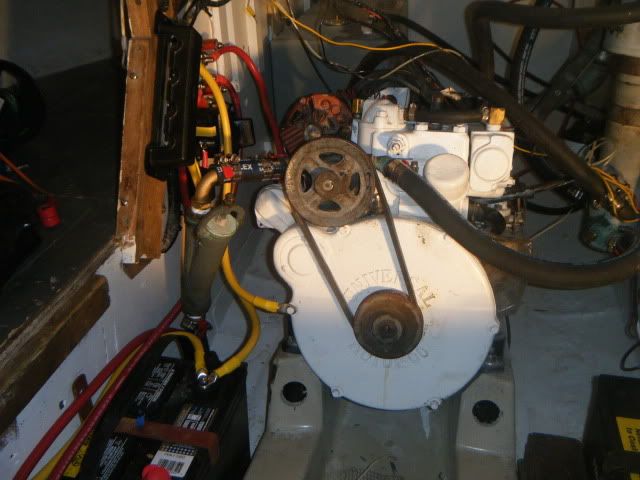

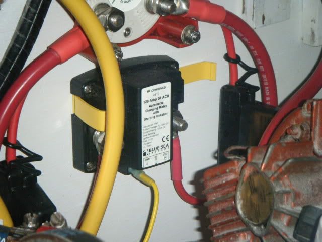

Withe the A4 a bluesea 200 amp fuse was plenty on each battery and i was able to keep the alternator wire 18" long by connecting it at the bluesea switch
The short jumpers connecting the ACR contain 80 amp mega fuses and have never had and issue in 4 years of use
