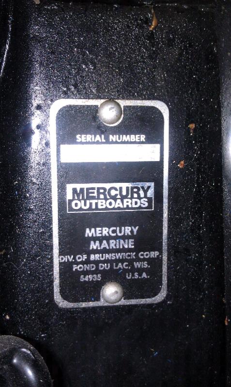

Cheers guys. We have a 9.9hp Mercury 180cc Saildrive unit. Looks like 80's/early 90's vintage but hard to know for sure. Did my best to trace on Mercury's site by s/N but to no avail.

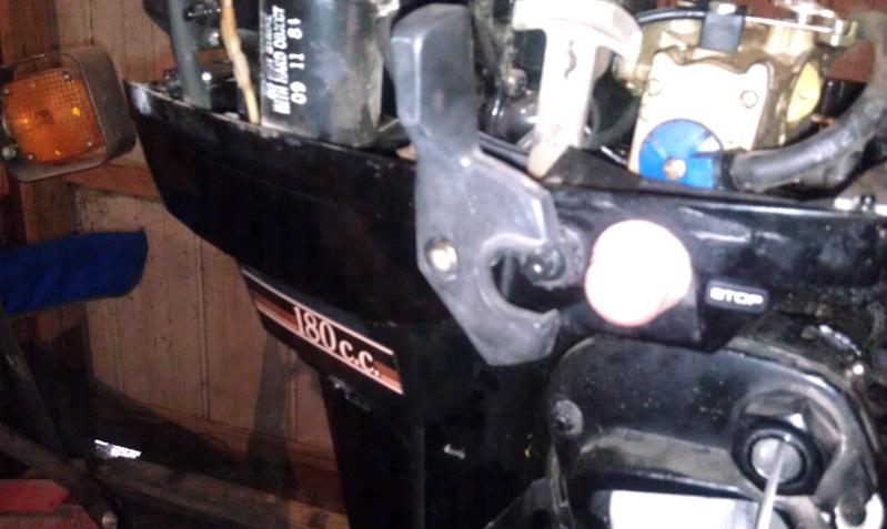

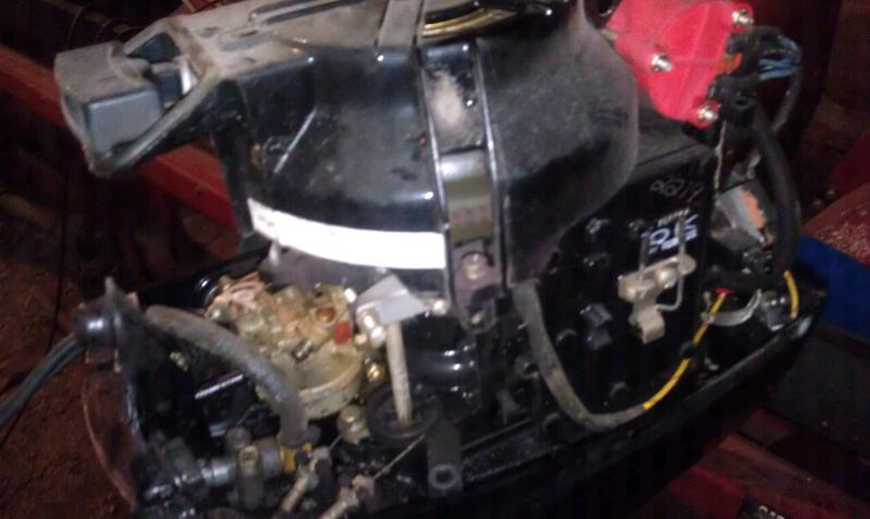

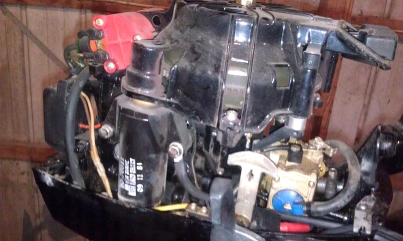

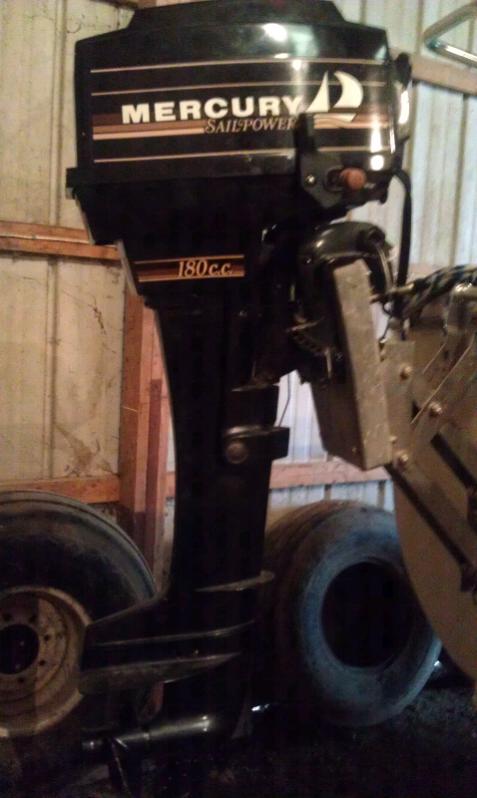

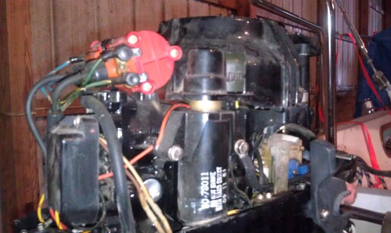

Hi guys. Took a few pics of the motor while down at the boat today. I appreciate the comments. If I do have the ability to charge the batteries while under power, can I rig a jump cable from the starter battery (its a dual battery) to the 'mains' battery and also charge that ? Suggestions or wiring diagrams most welcome...

Hey Milton, I've been watching this thread out of general interest, knowing little about an outboard engine, (mine's a steam engine, made by Fulton, with twin paddle wheels), but I can not imagine an engine, of any type, that has electric start, and no way for it to generate power for a battery, (alternator, generator, etc.). Even lawn mowers do that to some degree, although in the few autopsies that I have done on them, the charging apparatus seems to make little sense to me. For that matter, nothing makes sense to me too much...
But, if it were me, I would put a switching circuit on the batteries of some sort, you know, the one, two, both, off kind of switch.
And, upon cranking the engine, a simple volt meter will tell the tale of whether it's charging or not. And that being the case, I'd go ahead and put a volt meter on the panel, or elsewhere to monitor the rate.

One thing that I can't see in any pics is the front of the head where the control things are located (Like the Choke and on/off) There may be a plug-in connection somewhere or maybe even a hole for a wire to pass through. OFr my outboard with Elec. start..(Yamaha) The wire from the battery that serves to start the outboard also serves to charge the battery.
