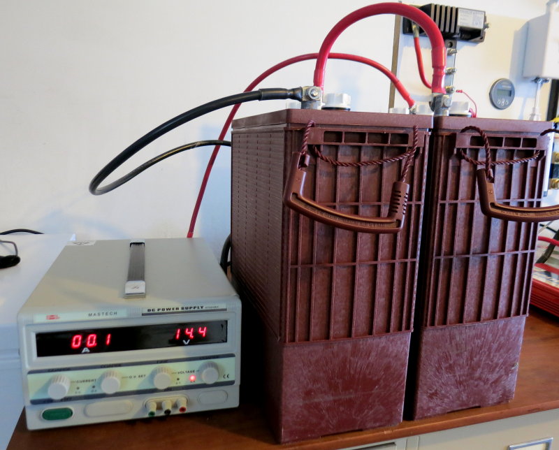

It is what I use. However I would advise a decent quality PS that has over voltage protection. Here in the shop we use a couple of inexpensive Mastech power supplies... We also have three BK Precision 60A that feature dedicated voltage sensing. The Mastech VOLTEQ series are specifically designed for battery charging, reasonably priced and pretty rugged. They are sure not the quality of the BK Precision power supplies but they cost many hundreds less. We have a 30V 30A model 3030EX and a 3050EX but they also make a 3010EX and a 3020EX too..

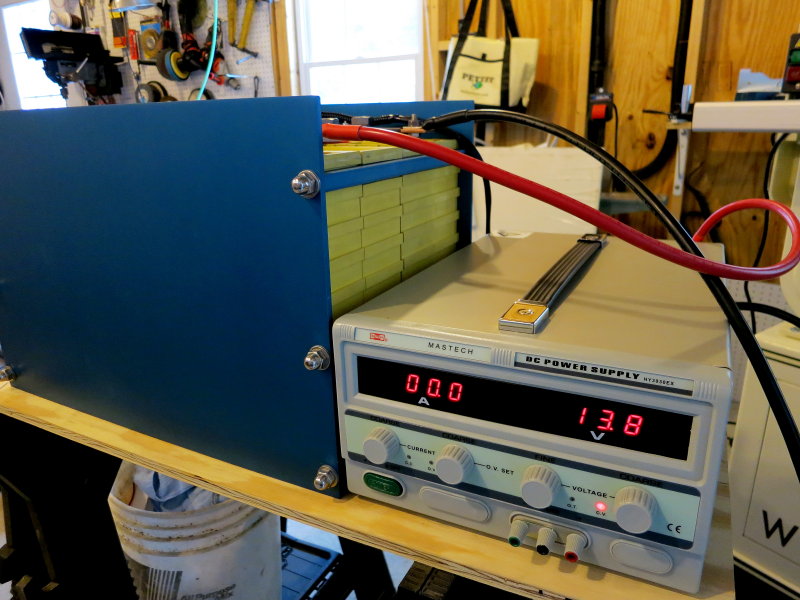

I think this is my Mastech 30A model # 3030EX. I also own a 3050EX
They are very handy tools:

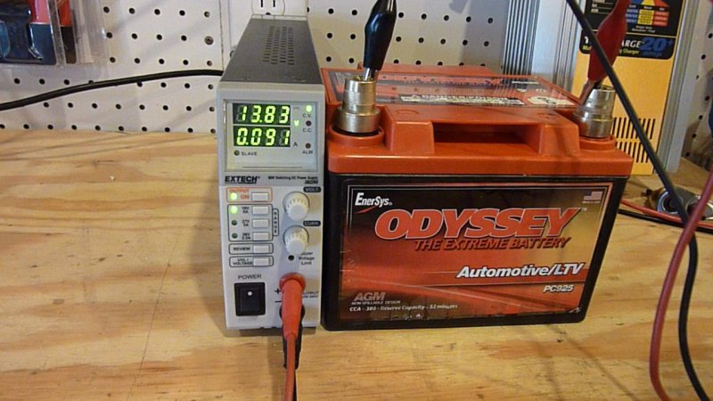

The little tiny ones are good for equalizing but this one costs as much as the 30A version and it is only 5A capable...
