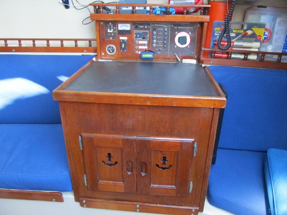

Attached is a random photo I found on the net of what the compartment looks like. The removable shelf we store stuff on sits just below the height of the anchors and batteries are in a fiberglass 'deep pan' or hanging tray below that.
I'll obviously get that food out of there...but damn, it'll hurt to give up that storage space!

Um, that is the nav station. And also were I keep my 2 house cells. Mine did not come with a tray but I purchased 2 marine battery cases that fit perfectly in the opening with the handles on the lip and hold my batteries.
I think storing cans on a shelf halfway up the space would be fine provided there is no way they can fall and short the posts.
On our boat I use the space for my DC distibution busses and shore charger.
Hydrogen gas rises and there are vents in the doors and also if you look there is an opening near the bulkhead/hull were the wiring goes up to the selector switch. Then the gas goes up and out the companionway hatch.

Garbone, yes, the top portion is the nav station and chart drawer.
However, on mine there is a floating shelf, and below that a Catalina-made battery compartment set in the lower portion of the cupboard. I'll take a photo next time I'm out.
