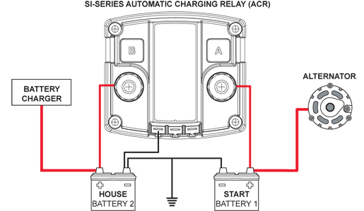

Another case for simplicity: http://www.vonwentzel.net/Battery/03.Banks/index.html
That is why I use an ACR. However, JCII's statement of never discharging/charging as a bank does not make sence and I don't buy it. Nigel Calder gives a very convincing argument for why "large bank of cells will always outperform the constituent batteries by themselves".

Batteries can certainly be ganged together or paralleled for charging and the advice to "NEVER" gang them together during charging is simply incorrect. It is safe, efficient and easier to parallel during charging. You can also automate paralleling with an ACR/VSR (automatic combining relay or voltage sensitive relay) to make it fully automated and require no human intervention to do so. It can also be done with a battery switch, though you run the risk of the HEF factor, or "Human Error Factor", and may forget to uncombine during discharge..
You do want to make sure the house & start banks are isolated during discharge so your thin plate reserve or starting battery is not cycled or so you would not potentially wind up with all the banks on-board depleted so deeply you could not start the motor..
Having one single, hard wired, large house bank is better and more efficient than having two separate house banks. This is so for many reasons, which would take another entire thread to explain things such as Peukert, acceptance, DOD, charge efficiency etc. etc.. Nigel Calder explains it well in his book, but there has also been much written about it here.
Perhaps the most simple and elegant solution is to run the charger as a single output to the house bank and then use an ACR/VSR to combine the banks and charge them both or use a B2B charger (battery to battery charger) such as an Echo Charger or Duo Charger to charge the start battery. The alternator, & solar or wind if added later, would do the same and use the same combiner or B2B charger to keep the start or reserve battery charged.
With many chargers you can also run one charger output to the house bank and one to the start bank, though they still only get one charge profile. Don't forget fuses within 7" of the + battery post in the chargers positive leads.
It would also help to know which charger the OP has. Some multi-voltage chargers require very specific wiring to work properly on a 12V bank and really may not be the best choice for large deep cycle 12V banks.

As long as both banks are the same chemistry eg: AGM & AGM or WET & WET or GEL & GEL than there is absolutely no problem doing this. In fact companies such as Blue Sea, Victron, BEP, Yandina, Sterling Power, Newmar, ProMariner and many others offer automatic COMBINING relays that only combine during charging and then automatically disconnect when under discharge. They do exactly the same thing as the BOTH position.
Yandina invented this type of device and have sold over 20,000 of them all with an unconditional guarantee. They are one of the more reliable devices used on boat.s These devices are simple, eloquent and work all without the voltage drops associated with diode type splitters..
Yandina Automatic Battery Combiner (LINK)
Blue Sea Automatic Battery Combiner (LINK)
Victron Automatic Battery Combiner (LINK)
BEP Automatic Battery Combiner (LINK)
Sterling Power Battery Combiner (LINK)
ProMariner Battery Combiner (LINK)
Newmar Battery Combiner (LINK)
All of the above devices COMBINE batteries, just like the BOTH setting. The difference is they don't forget to un-combine during discharge, like a human can...
