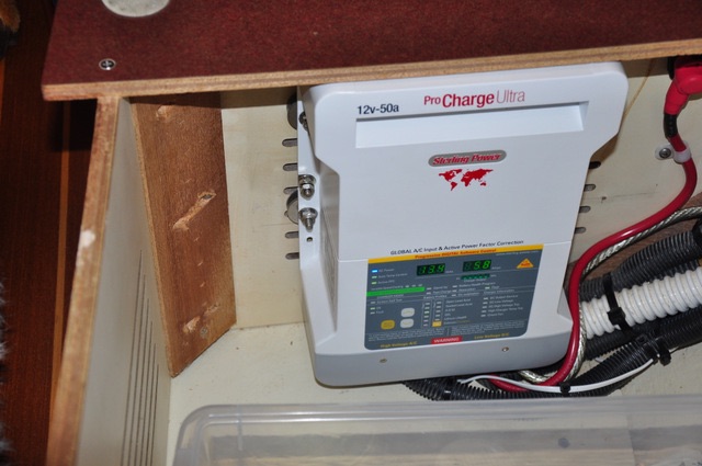

Looking to replace my old battery charger. Have been looking at the Promariner PronauticP series. Has anyone installed one in the same place the original charger was installed, cockpit portside. Will probably go with the 40Amp model. House bank is 450 Amps.

More importantly you might want to consider going up in size. Sizing is recommended at 10% of your batteries capacity. At 40 amps you are under that. Going to 50 amps might make sense.

We replaced our charger a couple of years ago. We have a 50 A. Sterling. Very pleased with how it performs. We have a 400 Ahr house bank, AGMs. We live aboard for 5 months or so of the year. Works well in a slip, it sits on float while the fridge, freezer etc. are turning on and off while it keeps a constant float voltage.

I went with the 20 amp model as that what was there from the factory and the way we use our boat the existing one was more than sufficient. It fit in the space where the old Charles did. If I had a little more slack in the wires I would have rotated it 90 degrees and put a bulkhead there so it would be easier to view in operation, but it is not that big a deal.
I still have to route the temp sensor wire but I can use it without it. I was able to re-use the factory cables as the ProNautic has terminal blocks for connections.
FWIW I understand the ProNautic is the Sterling charger, and both are recommended by MaineSail.

Our original charger was 40 amps, it had two outputs going to the two battery banks, house and start. I put a copper bus across the 3 outputs on the Sterling charger and connected both original battery feeds to it. They terminated at the two battery connections on the battery selector switch. I connected both feeds to the house battery bank. The start battery bank is charged with an Echo charger off the house bank. So we just leave our battery selector switch on the house bank. When on shore or our generator power both banks are automatically topped up.

That's the beauty of it
Since the charger has a terminal block, you undo the old leads (120vac input and 12vdc output) and connect them up to the new one. You will need to run a separate ground wire to the bus bar behind your power panel and the included wire with the RF-11 (?) and terminal lug (that I understand is a thermistor).
BTW, my ProNautic looks nearly identical to the Sterling in the picture.
On my 310 I needed to splice in 5' of wire. There are only two wires inside the wire and I just happened to have some similar wire on the boat. Pays to be a pack rat sometimes. :D
Ran the temperature sense wire on the port side under the rear bunk. Note there is an extra 1" tube outboard of the tube where the wires from the battery charger are run that goes under the head. Pretty simple.
