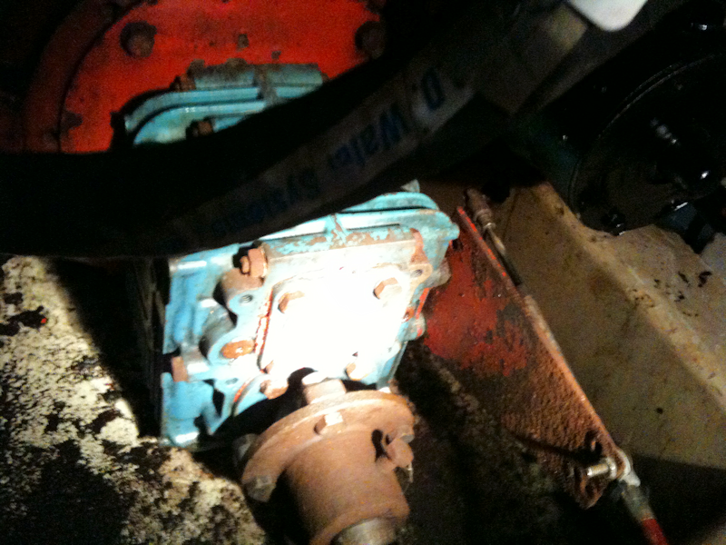

Thanks RAD - the tranny shifts confidently into forward every time, but shifting into reverse is a gamble. Usually it will go about 15-30 secs after you put the lever in position - which makes docking extra fun! I've changed the fluid multiple times and spent hours playing w/ the linkage trying to find a sweet spot, but no go. The fluid also seems to get fouled (milky pinkish) pretty quickly which makes me think water maybe finding it way in somehow?!?

First let me tel you if your tranny is a SAOD type then reverse doesn't click into place you have to apply pressure to the shift lever and there is an adjusment.......your getting water into the tranny from where? stuffing box leaking a lot of water?, is there a gasket under the cover I made a nice gasket from some rubber gasket material from the auto parts store. is the deck leaking onto the tranny? mine is right below the steering pedestal
If you need a tech manual for that engine and tranny let me know cause I have it in my pdf library

we have the hurth short profile sailing gear trans - as for the water, the current observations are as follows:
-The engine is mounted at about 8-10deg angle, so water shouldn't be flowing up from the stuffing box.
-There's no visible sign of leaks from the base of the cockpit to drip down (even checked w/ scuppers plugged in the rain).
-No sign of water in the engine oil (no milky discoloration)
-Changed engine oil, after several hours of runtime no discoloration
-After a fresh trans. fluid change, signs of water in the transmission fluid after running the engine for a few hours in gear
-No sign of head gasket failure (no significant white smoke in exhaust on startup or after warm up and thermostat open)
-There is a pint or so of new water in the engine tray after a several hour run.

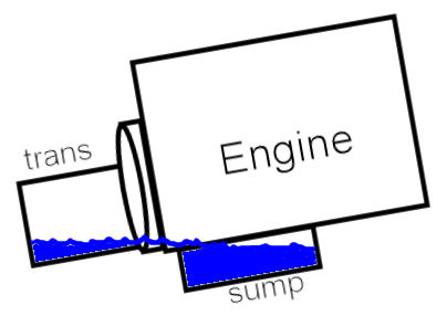

The current theory is there must be a small leak in the heat exchanger to the engine block - small enough that the amount of water in the oil is not enough to significantly discolor it after a run, but still enough to accumulate in the sump after cool down - b/c the engine is on an angle its enough to get past the 30yr-old main seal and into the tranns. (where the small amounts of tranny fluid involved are easily showing the signs of water).

Interesting.....I'm convinced about the rear main seal leaking but not into the tranny and a few tablespoons of water will milk up oil thats been sucked through an oil pump and water is heavier than oil so it'll be below the seal, I'm not to familiar with the Hurth so I can't input
