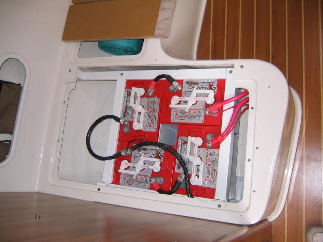

Hello, Board members! Anyone with a 310 change out their 2-4d's to 4- 6volt golf cart batteries. I was looking at the space and am not quite sure if they will fit. Height is big worry. I was hoping to add a starter/reserve battery in there as well. I could bust into the adjacent storage under the port settee as well to get more room. Just thought I would ask before I start down the path.

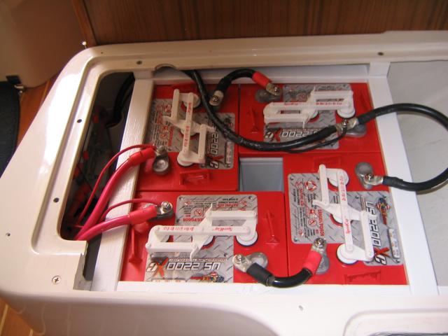

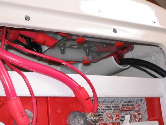

I did this project last year and they fit just fine (see photos) on a 2003 vintage. I used US2200XC batteries by U.S. Battery (see pdf). The difficult part was re-configuring the hold down system -- I re-used the original 2 x 4's but cut and notched them and used stainless bolts and tee-nuts for ease of removing. I also relocated the high-amp fuses onto a block up towards the top of the compartment. When situated as shown in the photos, you can access all caps to check water level and refill. I did not add a start battery but I think it (a group 24 or 27) could still fit inboard and forward in the compartment. Note, the cut out in the fiberglass compartment forward edge was there from the factory. It sure is much easier on the back to move these 6V batteries compared to the original 4d's. Hope this helps.

As I recall, they were approx $85.00/ea at the time--found them at a local battery shop--so I could simply go in and pick them up (and turn in the old for the core charge).
