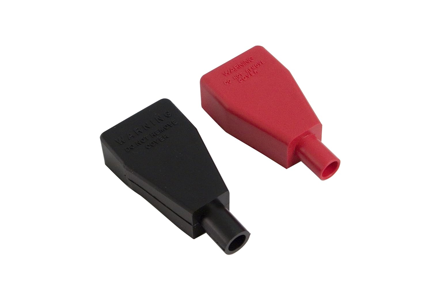

Please note that the CFR does not define how you protect the terminals just that "metal objects" cannot come in contact with the positive battery terminal. If your batteries are installed in such a manner that metal objects can't physically come into contact with the battery terminal, then you PASS... This can include but is not limited to:
*Terminal boots
*Battery box lids
*Battery compartments

To prevent accidental contact of the ungrounded battery connection to ground, each battery shall be protected so that metallic objects cannot come into contact with the ungrounded battery terminal and uninsulated cell straps. This may be accomplished by means such as:
10.7.7.1 covering the ungrounded battery terminal with a boot or non-conductive shield, or
10.7.7.2 installing the battery in a covered battery box, or
10.7.7.3 installing the battery in a compartment specially designed only for the battery(s).
