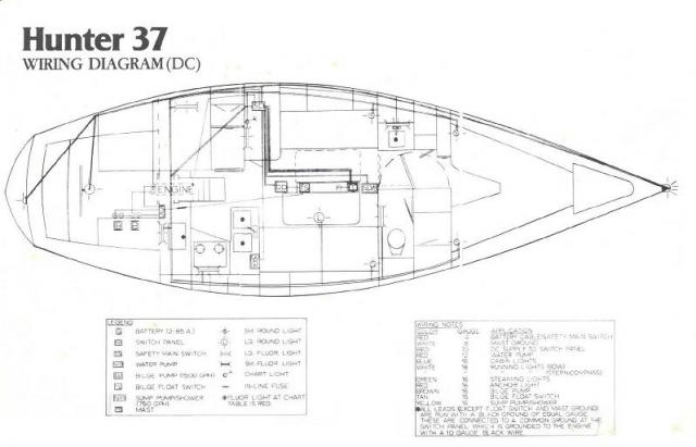

37c DC Wiring Plan
Jack,
Here is the DC wiring diagram from the original owner's manual. This is a jpg. I've also added a pdf that provides a cleaner view.
Note that batteries "B" were in the aft stbd locker originally.
Jim
