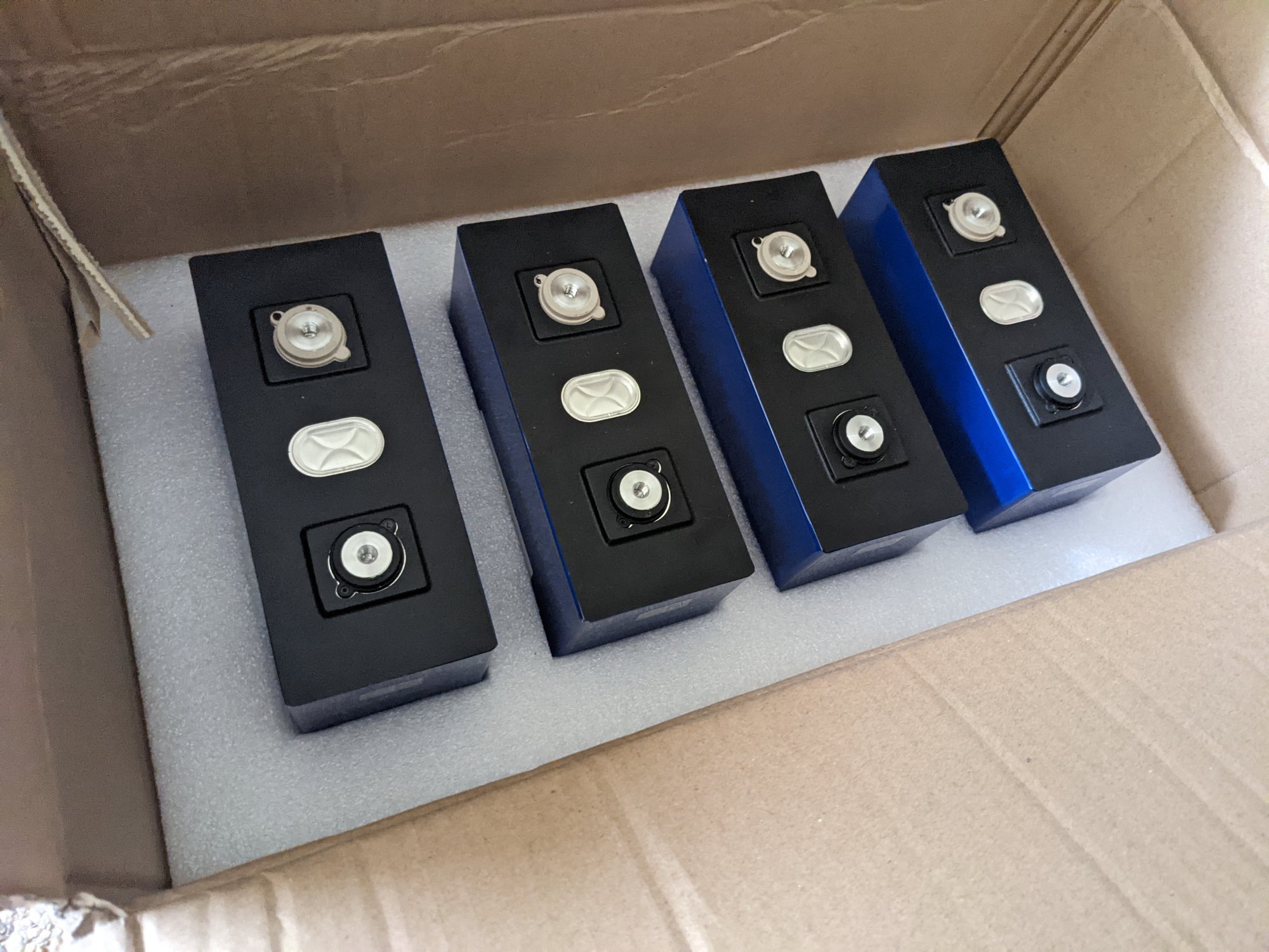

83 days after ordering they have arrived!
Got my 1/2 starboard and should be installing this weekend.
