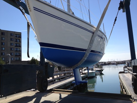

I bought this boat in 2008 and it had a fresh coat of ablative bottom paint. I sail on the Chesapeake. I have taken the boat out every winter, and had marina applied bottom paint each spring. The last two years the bottom has been flaking in three to six inch size chunks. The marina is recommending a soda blast, followed by three coats of epoxy barrier coat. Followed by ablative. I contacted Catalina, and their personnel referred their documentation on the subject, which makes no reference to the need to apply a barrier coat, because of the vinyl ester layer. It discussed dewaxing, sanding, but nothing on applying a barrier coat. Am I wasting money, and or potentially doing more harm then good to my Catalina? I'm trying to not do something stupid by skipping the barrier coat. The marina contractor is adamant that a barrier coat is needed. Can someone bring me some sanity on this issue.
