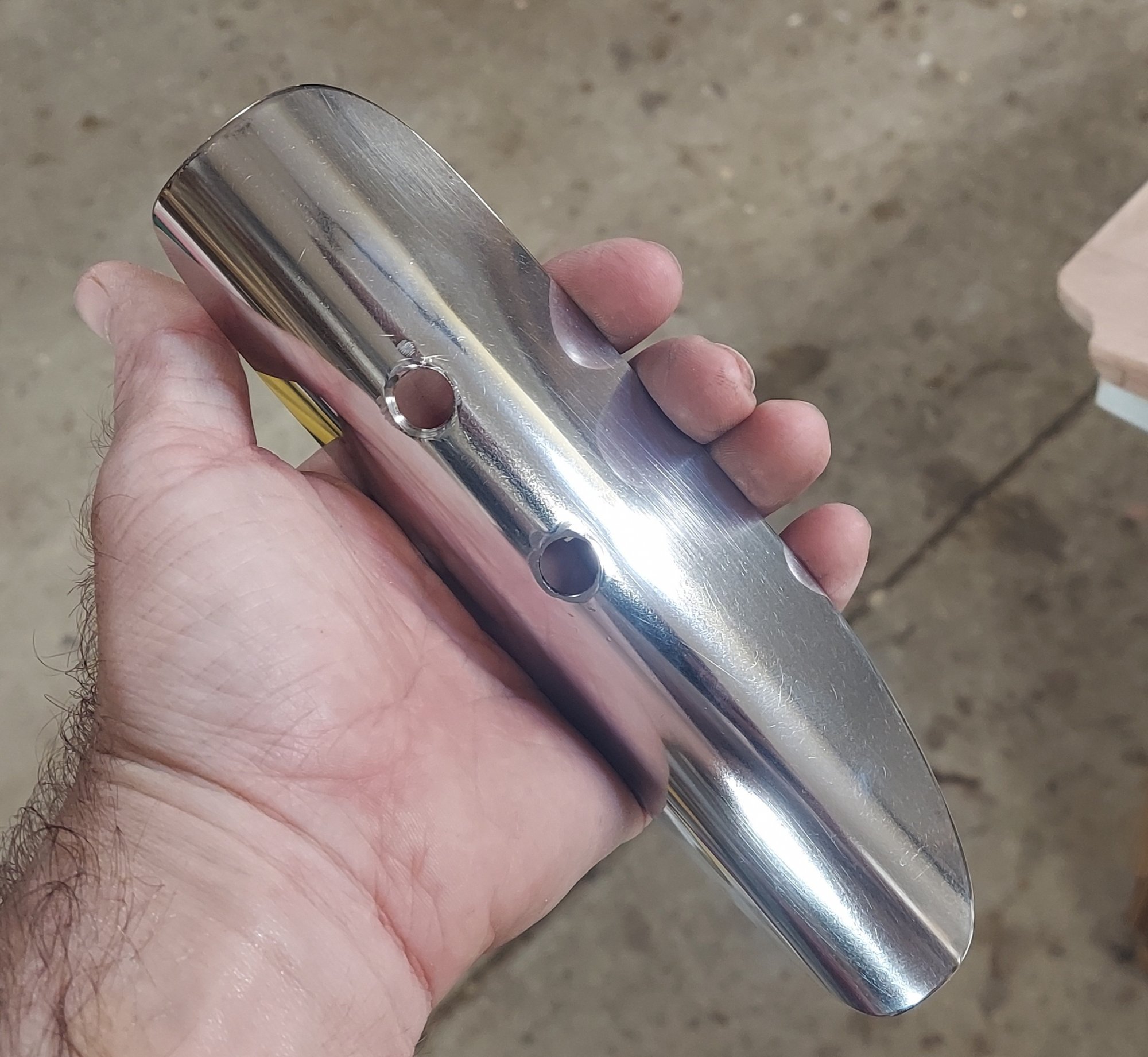

After much swearing and dulled drill bits, my polished 316 guard is ready to install. This finishes off the tow-eye rebuild and will be the first start-finish completed job on the boat.
Butyl tape seems capable of sealing the u-bolt thru holes? 5200 seems like a bit too much. For the guard, I'd like something between the steel and my gelcoat. I was thinking of buttering it up with some silicone or soft'ish polyurethane coating and allowing it to dry before installing.
Anyone have a product recommendation?
