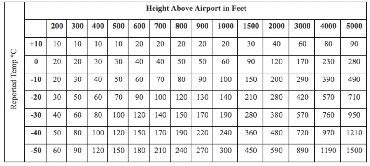

Here is a report about temperature affect on altitude readings. Altitude readings use a barometer to identify altitude by calculating the difference between a set barometric reading at a specific altitude and the barometric reading at the identified altitude.
My guess is that the difference in temp from inside and outside the house will not be evident on most barometers.
"How much does temperature affect altimeter readings?
As mentioned earlier, we can easily calibrate the altimeter for non-standard pressure settings, but we don’t have a similar mechanical calibration for non-standard temperature settings. There is a somewhat simple calculation to roughly estimate the variance, and it is 4 feet per degree Celsius of difference from standard temperature for every 1,000 feet above the reporting altitude.
In other words, you need two inputs:
  • Difference between actual air temperature and standard temperature
  • Altitude above the reporting location (for example, your destination airport)"
