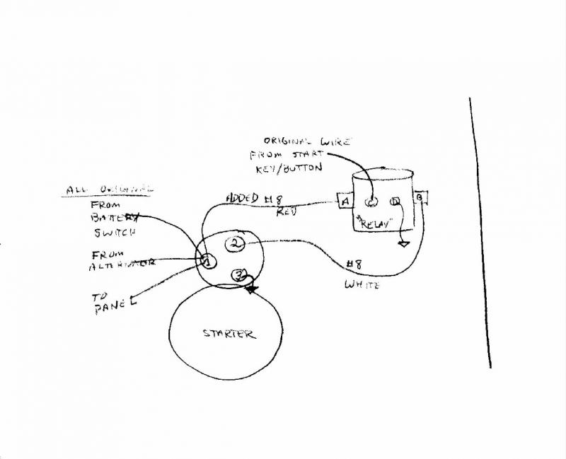

Hey Barkley,
Had the same problem. This seems to be a common problem with the older Beneteau 30 footers. It has been addressed on this forum before with a couple of suggested solutions.
Here is a link to a long related thread:
http://forums.beneteau.sailboatowners.com/showthread.php?t=111855&highlight=starter+relay
I just (last week) added a relay into my starter system to correct this issue. Now she starts every time.
I have attached a diagram I got from this forum.
PM if you want more info.
cw

I have a 2000, 311. with a Yanmar diesel. Yesterday I went out for a sail, all was fine until I was ready to return to port. the engine would not start. checked the usual fuel level, battery connections and they had plenty of juice, starter would click but that was it tapped the starter no results. Any ideas, replace starter? How much and is that something I could do myself? Thanks for the help.
This is a real common problem for Beneteau owners with Yanmar power plants.
Yanmar supplies the wire loom along with the diesel. The wire that runs from the start button to the starter solenoid is undersized and just barely adequate (when new) to carry enough current to engage the solenoid and keep it engaged when the starter motor tries to turn over.
The fix posted by Cwoody is the most common repair.
