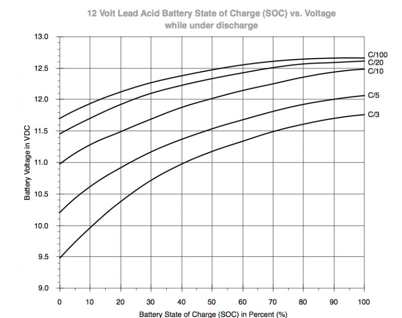

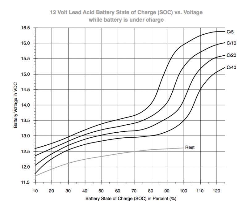

SOC with amp and volt meters only
You folks do know that you can measure the SOC by knowing the amps flowing in/out and battery voltage right? You do NOT have to wait for 3 hours with no amps flowing to use voltage to know the battery SOC
Google and being able to read are handy tools
Jun 6, 2006
6,990
C/x values are battery AH capacity / amps (in/out) so
if you have a 400 AH bank....
C/5 = 400/5=80 amps
C/10 = 400/10 = 40 amps
Feb 6, 1998
11,759
C/5 = 400/5=80 amps
And you do track the changes with age in your spread sheet at varying loads........? Because it changes and loaded voltage does not remain stable. You would need to re-test for this regularly. It is funny because I was recently discussing this exact scenario with the chief engineer at Lifeline battery for some testing I am conducting for one of the sailing publications which involves Lifeline batteries..... Lifeline is one of the few who publish loaded voltages but they don't remain accurate for very long and would need to be re-calculated..
