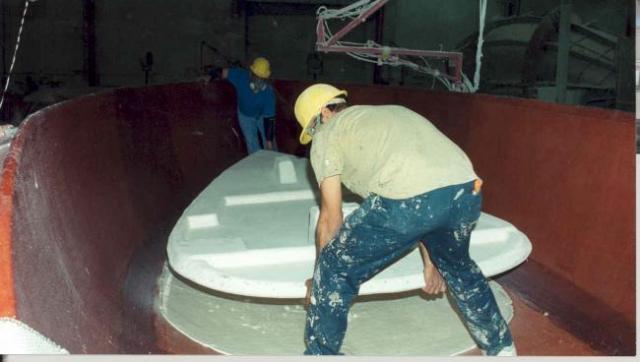

This image of the tank top during assembly might help you. I wouldn't drill an access in the v berth area because as you can see from the image the only other spot near the same level as the air valve is the base of the mast. I believe the top of the tank with the exception of the mast base and the air vent is all located below the water level outside the boat - a hole in any other are could cause flooding!
http://sbo.sailboatowners.com/index.php?option=com_mtree&task=viewimage&img_id=6863&Itemid=257

Thanks! That is exactly what I needed to know!!!
I need to take a closer look at the boat this weekend to try to figure out what is going on. It will have been sitting in the water for little over a week and may have corrected itself.
