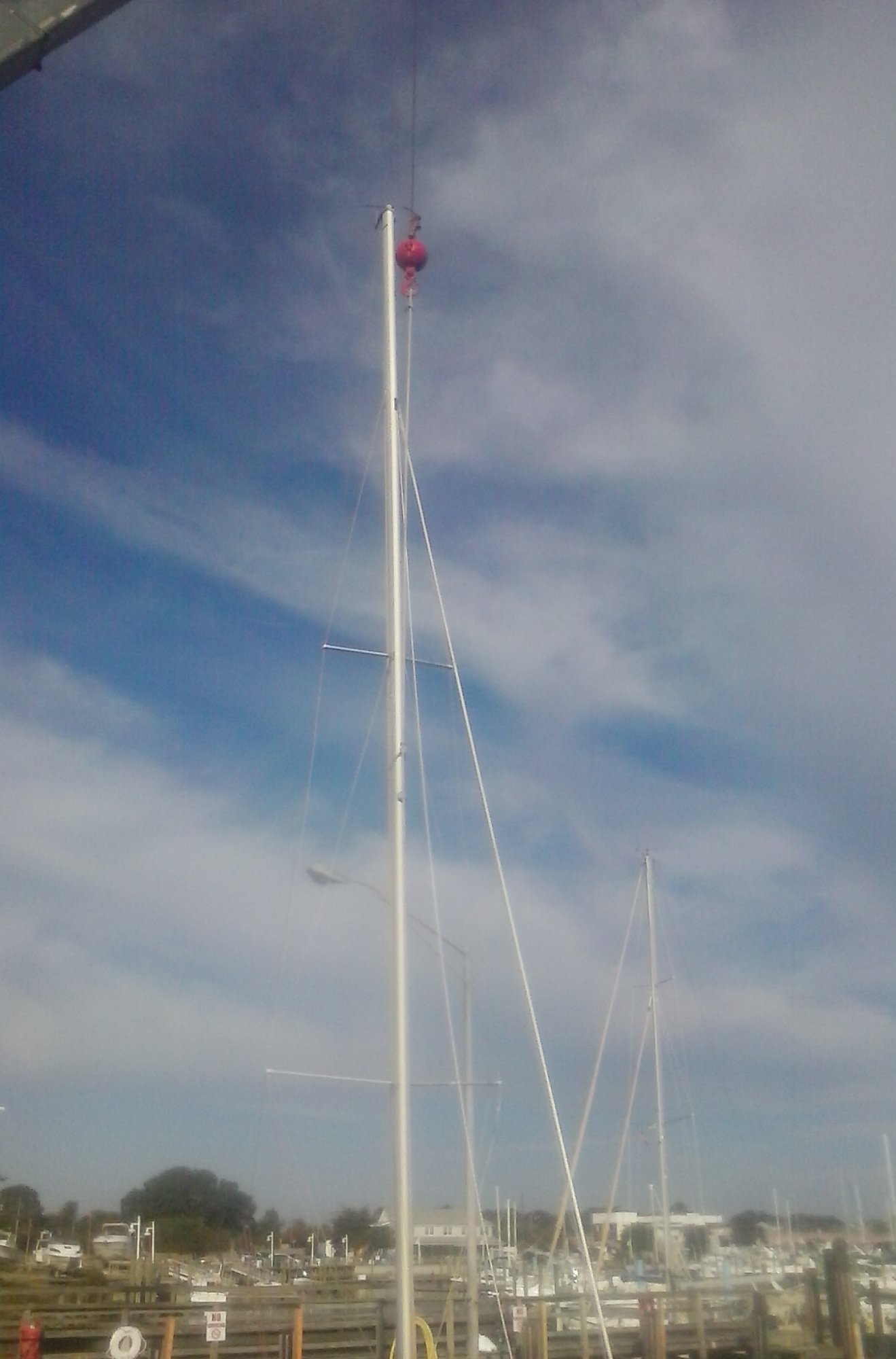

You need to take the head-sail off the furler. You probably have a mast with two sets of spreaders. Your lifting point CANNOT be under the bottom spreaders as the mast will topple over when lifted. It could be under the top spreader but that puts a lot of weight on the mast foot when trying to bring it on the supports. You need to raise from a point about 2 feet above the steaming light.
Attached is how I do it. I do step and un-step my 34 for trips every summer. 3 times each way. I also do 20 to 25 other boats to help club members and I teach how to do it. Until you get some experience, try to enlist someone who does. It is a pretty big mast and accidents can not only do damage but hurt people severely.
