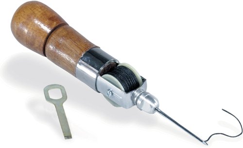

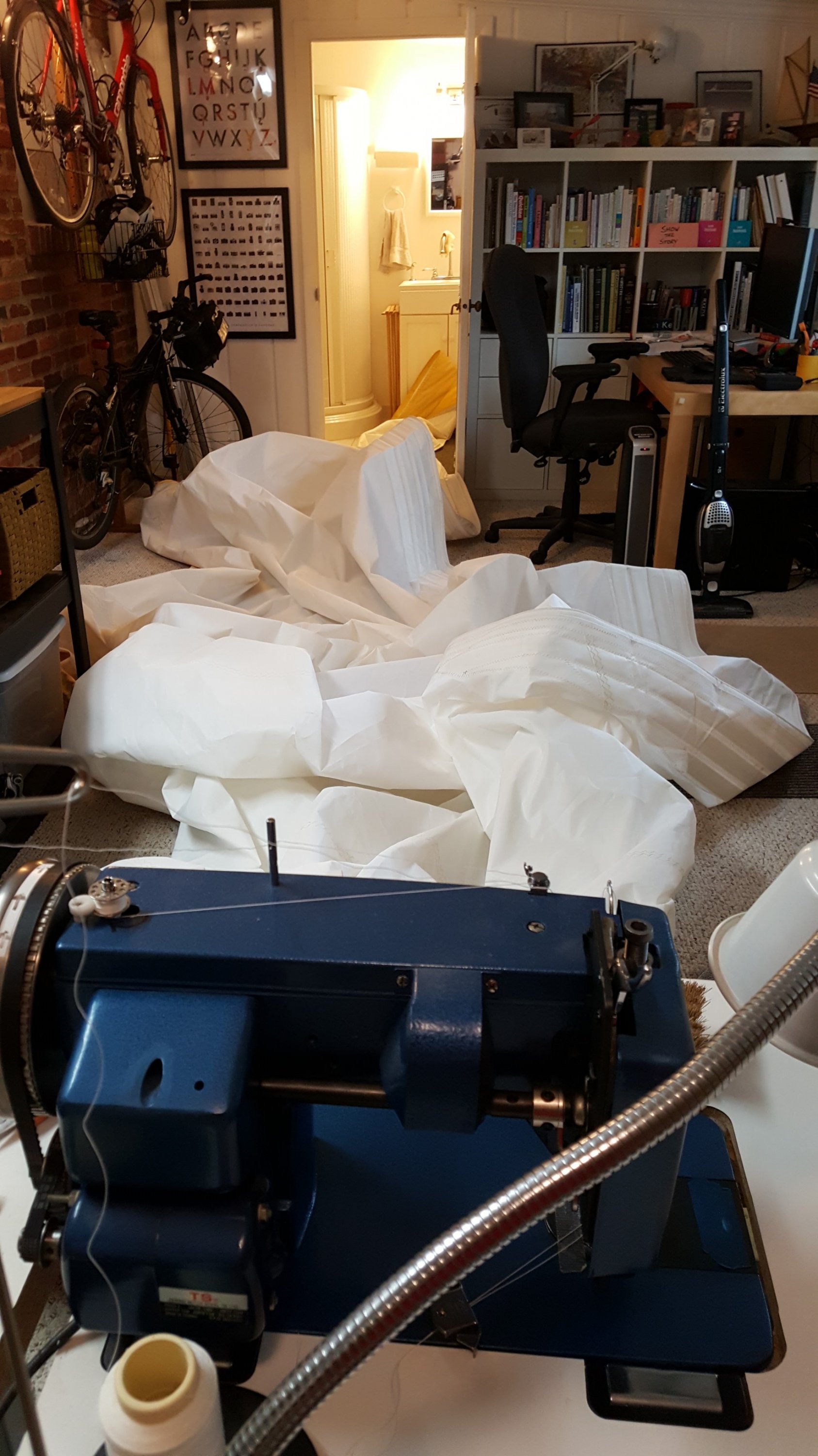

we have a top of the line Morse "really good vintage pre-1960's home machine with metal cams and metal gears..." i tried to sew a winter cover for our 30 ' sailboat on it. however, the most the home machine would do was 4 layers of sun brella or 2 layers of top gun winter cover material. .it certainly would not do "...4-6 layers of dacron and 2-4 layers of sunbrella. " the feed dogs on the home machine aren't built to feed heavy material well. so the spouse had to hand - pull the cloth as i fed it into the needle plate. and even with 2 people, then the thread kept jamming and the needles kept breaking. a home machine motor cannot drive the needle thru the layers judy b opines it will. i ended up buying a sail rite machine which was a great investment. the machine cost $500, fabric and supplies were another $350. the cover lasted from 1994 and was still in great shape when we sold the boat with it in 2006. the quote from the local sail yard was $2000 for them to make the cover -- with a 4 month lead time.
the hand awl is your other option, and it will make you feel like an 18th century salon, which sometimes is a good thing.
