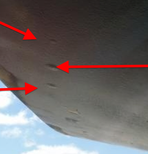

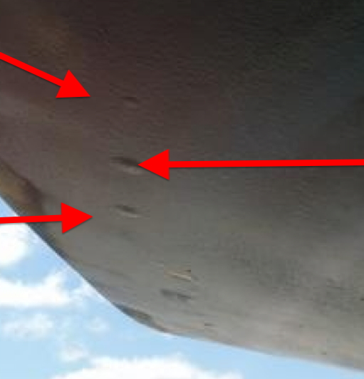

that crack may be a blessing in disguise ......if you gelcoat was marginal it very well could have been a seed to a future blister problem.....is you hull cored....if so look on the inside as well.....

Agreed. Keel should not be hanging free.
It's not, the keel is blocked up. In fact the boat was set on the blocks then the stands moved into place and adjusted for support. They (the stands) also have wood support. They just don't show in the photo.

I have noticed some oil-canning from the stern stands in the past. Fortunately, no permanent damage was done. Hopefully, the cracks you show on your hull are cosmetic.
Catalina 310s are made with vinylester. So there is no blistering concern. The hull is solid glass.

Just looking at the photos again and I noticed something. It looks like fresh bottom paint has been put on and the stands may have been moved to apply bottom paint. Did the yard move the stands?
