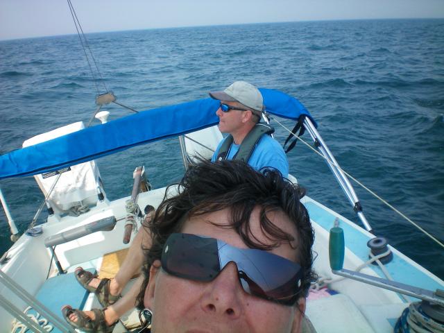

I believe this is a venture 25 and you can barely see the split backstay setup on it.
Oct 8, 2008
362
MacGregor/Venture 25 Winthrop Harbor, IL Drummond Island,MI
I have a '75 V25. I kinda think it was added later, but I have a split backstay. To tighten the backstay, there is a sheet behind my right elbow(swivel block with cleat) that draws the adjuster(think thats what it is called) down, pulling the split backstay together,making it tighter.
Clear as mud?

Who's being a comedian??? If he's looking on the center of the transom, he could easily miss the chainplates in the corners of the transom.

Sailingdog, I was referring to ignoring the picture of the Admiral in the foreground to look at the backstay in the background:) or something like that:doh:
Oct 8, 2008
362
I'm thinking that the original end of boom sheeting used those two eyelets to attach blocks for the mainsheet. My mainsheet is now on a traveler in front of the companionway. The backstay now uses those eyelets to attach flexible SS wire for the backstay and the 1/4" line which adjusts tension on the backstay(hard to see in the pic) it pulls on the center sheave of that 5 sheave adjuster to change tension(drawing it down).
