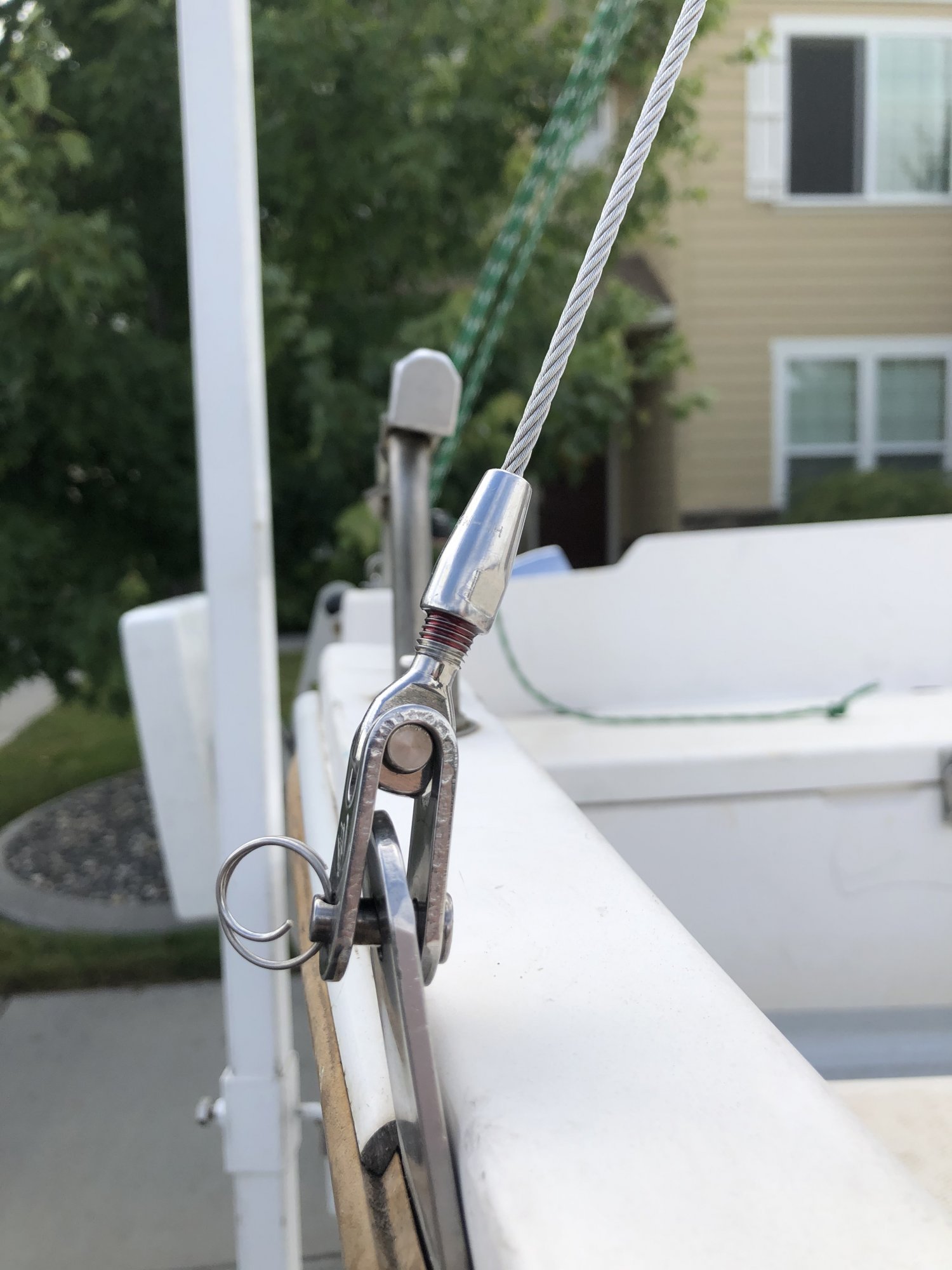

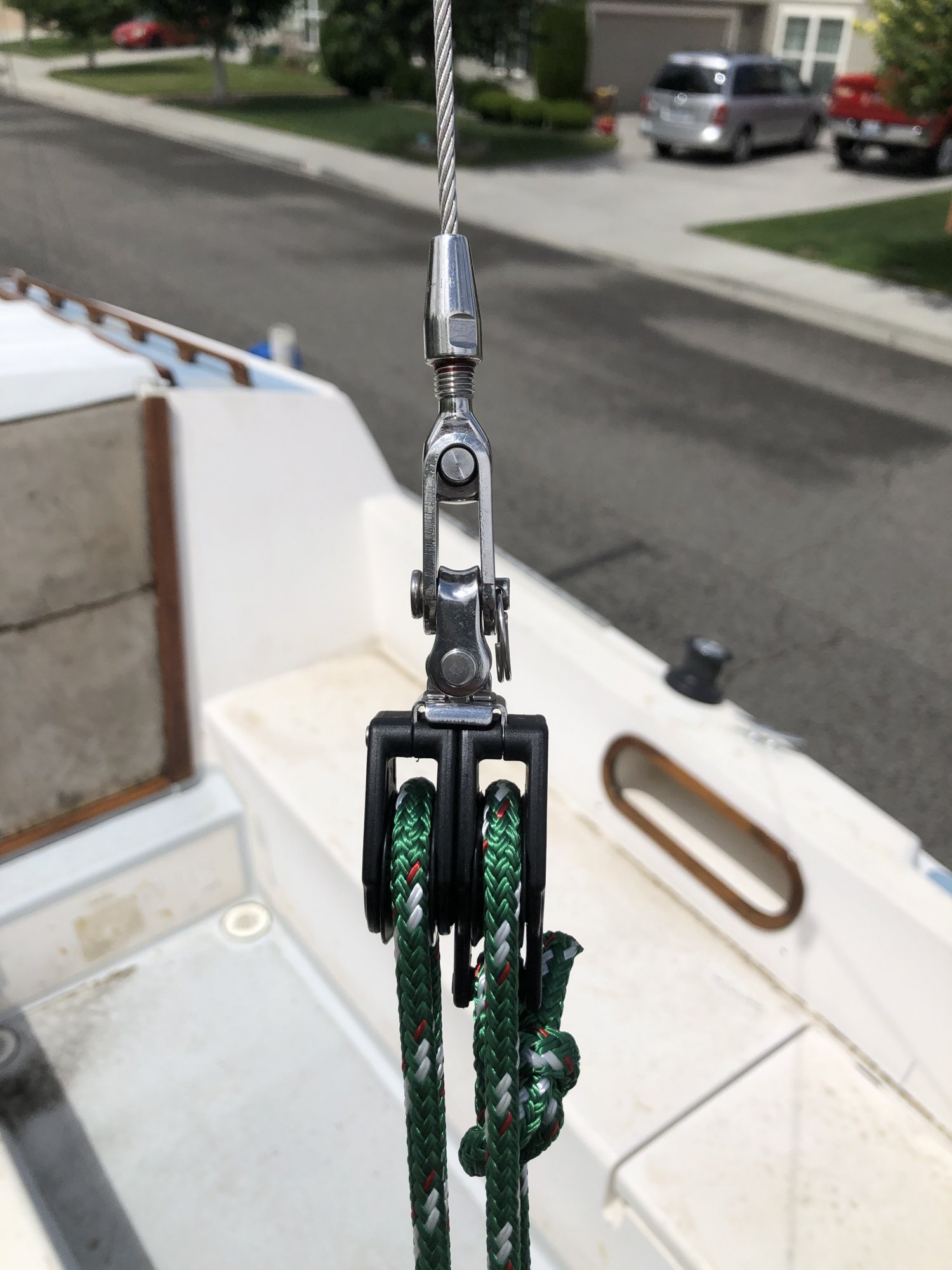

+1 for @AaronD as usu-- You can certainly build your own if you want to go there. I replaced all of my standing rigging (zero previous experience). My backstay (possibly like your original) was split, but not adjustable. I really enjoy the fact I can stand the mast with a loose backstay-- make the forestay connections and then tighten. Some images of what I played with prior to committing-- and I have some interesting chainplates provided by my PO, but would apply to your factory eye bolts.
