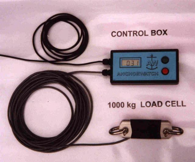

Its called "ANCHORWATCH"
Well done Main - great video.
Yes it has been done but I guess nobody told America.
A few years ago John Knox (Professor), also a sailing instructor, from Edinburgh, adapted a Load Cell and did a series of tests on his anchor rode under a range of conditions.
He went on to manufacture and market the unit shown in the link(s) below.
It can be used for every anchoring and can even alarm if you drag.
I agonized over buying one (£199 ~ $300) to do exactly as you are now doing but miserliness got the better of my good intentions.
The whole was written up in two of our sailing magazines, both of which I still have, so I will try to locate the item and post it here (if the author agrees).
http://www.anchorwatch.co.uk/
This is covered in more detail in two articles by J H Knox (1) Anchoring by Numbers, Yachting Monthly, August 1997 (2) Snatching at Anchors, Practical BoatOwner, February 1999. The main conclusions are summarised below.

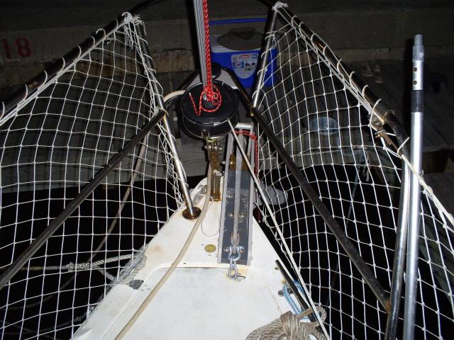

When I first started trying to anchor I had all kinds of ideas to make it easier. I just bought a chain hook for when I am by myself to make it easier. It's almost comical but almost every invention I think of has a one-way device in it. I seem to always be using a ratchet and pawl or a clutch bearing. For my 30' boat I wouldn't even take the time to install a windless if someone gave it to me. The only thing that I think would make retrieving the anchor easier is to use something like a chain stopper. It IS a one-way device but I think it can be improved upon, at least how I retrieve the anchor I think it could be. I think a cam cleat device made for chain with a fair lead that flips over it would be better than a chain stopper, because it's too much trouble to get the chain into it. It should be as easy as using a cam cleat.
I just discovered load cells about 9 months ago. I use them now to determine the force on a brake pad on spin bikes/run rocket to determine what "level" some one is exercising at, something I believe has never been done.
I wish there was as easy way to hook a strain gauge up to the shrouds. I would really like to know how much force there is on an upper shroud while the rail is in the water.
Jibes-I build a bow roller with the intention of having a chain stopper or a cam cleat-made -for-chain installed on the back by where it goes into the anchor locker. Yeah I know my boat is ugly, I'm working on it.

OK I think I have something. Do you have a picture of your bow area like the one I posted? If you already have one of those $40 winches, you'll need a way to have a platform to mount it on and someway to hook it to the deck.
If all you need if 20' of hauling power, you can sew small hooks into the strap. every few feet. Pull all the strap out. have your anchor with a 1:1 scope. Have the winch sitting ont he deck hooked in(however it will be). Pull out all the strap, use the hook closest to the winch first and start cranking. As that hook gets to the winch, hook the next hook up on the chain. repeat until the anchor is up. I think It would be best to have a chainstopper so you progress will be saved without any chain slipping back out.
If you have a winch on the mast for a halyard, you could use that as well. Make a strap with hooks in it and winch the strap up onto the winch using the same method.
IT would work best with a winch on the mast.
Edit addition:I change my mind. You could have a rope with a one chain hook on the end. Use the winch on the mast to crank the anchor up, the chain stopper saves your progress. Unhook the hook and repeat the process to pull your anchor all the way up. The chain stopper should be mounted near your bow roller. You'll be able to crank up 8' or 10' at a time before repositioning the hook.
http://www.amazon.com/Sea-Dog-3218251-STAINLESS-STOPPER/dp/B002IV8GAK
That's the type of chain stopper I am talking about. That, 15' or 3 strand and a chain hook and you should be able to pull up 100 lb. anchor.
