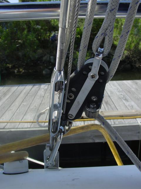

Because of the design of my bimini, I could not use the type that pulls the two wires together, so I installed a 16:1 adjustable backstay by drilling an additional hole in the flounder plate for a block, then doubled that into another block and a 4:1 adjuster. I left the OEM backstay in place for redundancy, and just backed the turnbuckles off. The only trick is to find a couple long chain shackles that will fit over the turnbuckle tangs and have the pin fit also. If you disconnect the backstays and bring them forward you can reach everything from a step ladder on deck.

Very well thought out! No qualms about drilling a hole in the flounder plate? Bitch drilling stainless must go slow with oil. I suppose you could used a cable clamp just above the flounder plate with a 1/4" eye bolt inserted in the other half of the clamp to attach the block to.

I'm a structural engineer by trade, so i'll admit it did perform some mental calculations on the shear load in the fish plate. Even if you pull 100 pounds at 16:1 it's less than a ton of load so it is nothing to worry about. Keep the edge distance similar to the other two and you are good to go. Just drill slow with a couple of intermediate bits. If you go the wire rope clip method they should be re-torqued periodically (but if you leave the OEM wire in place even if it slips its no big deal).
