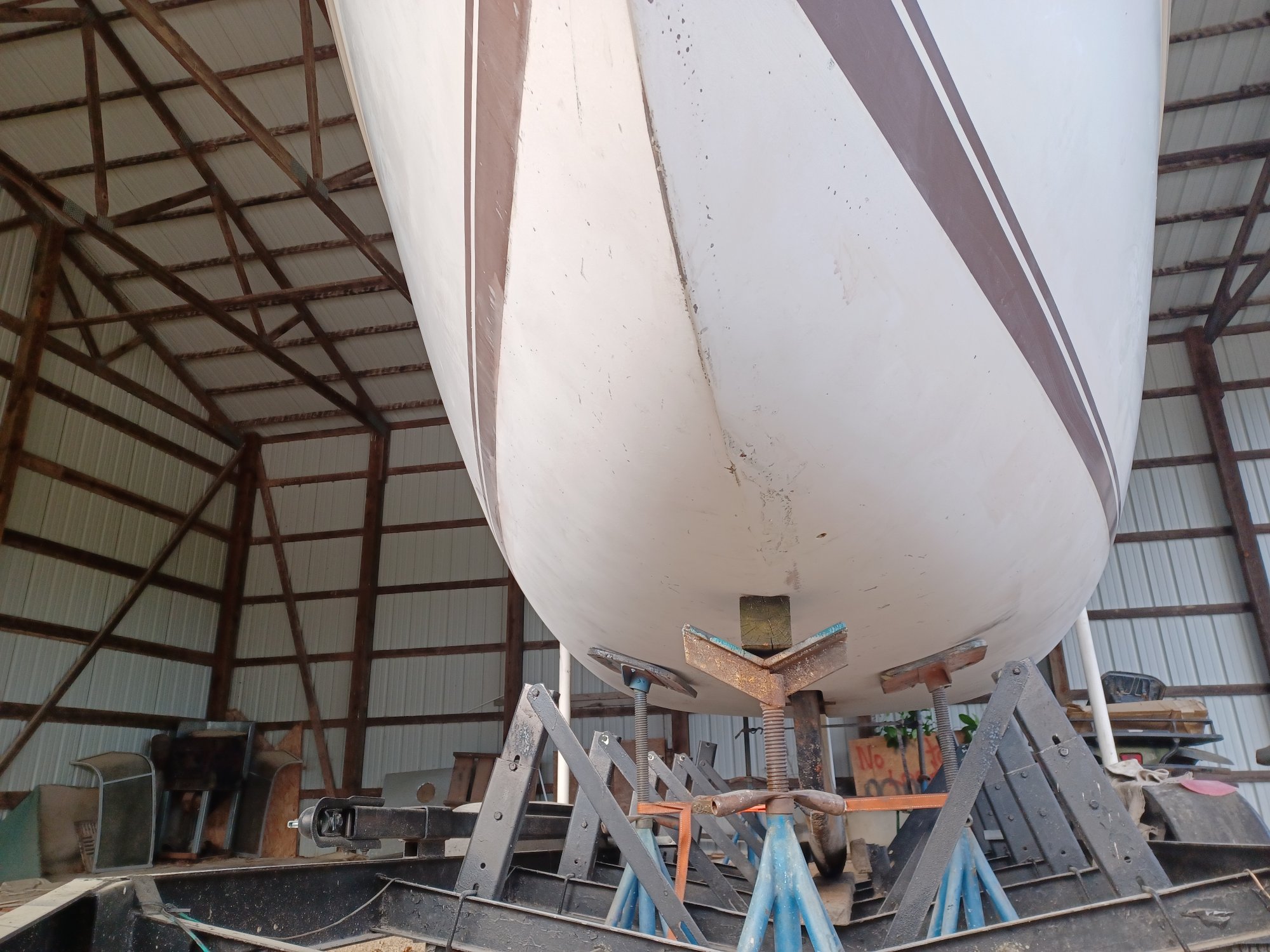

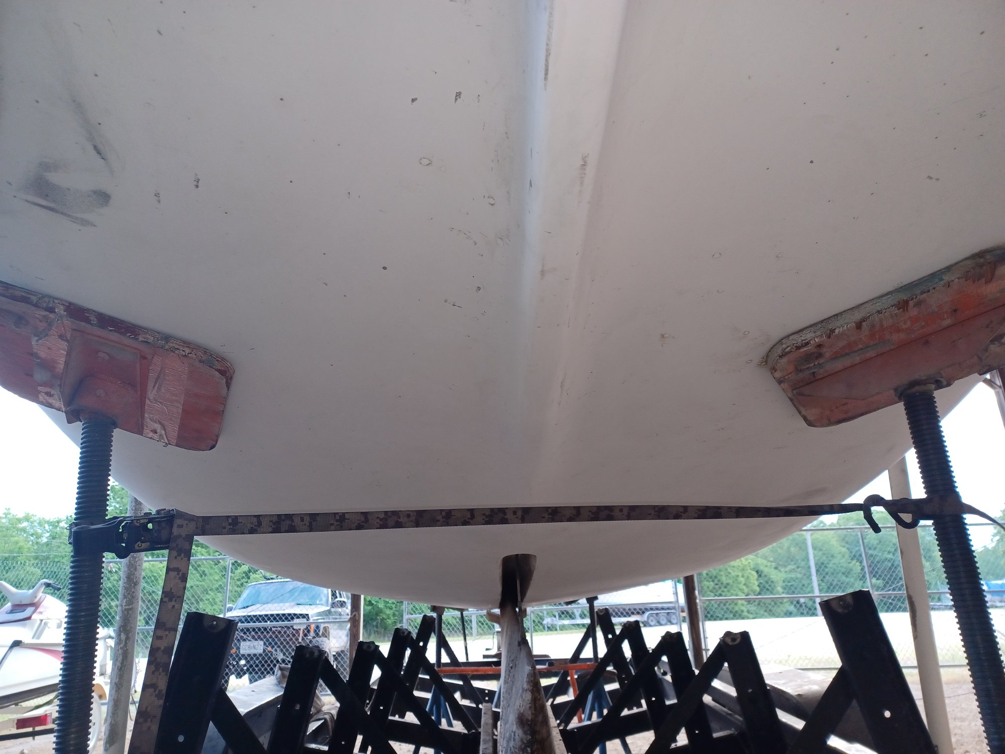

After a few months of sitting in inside dry storage, and another unexpected boat restoration....I put her on stands yesterday, pulled the trailer bunks and have it almost completely sanded.
By my math, there is about 200sq ft of bottom to paint on a c25. Does that sound right?
