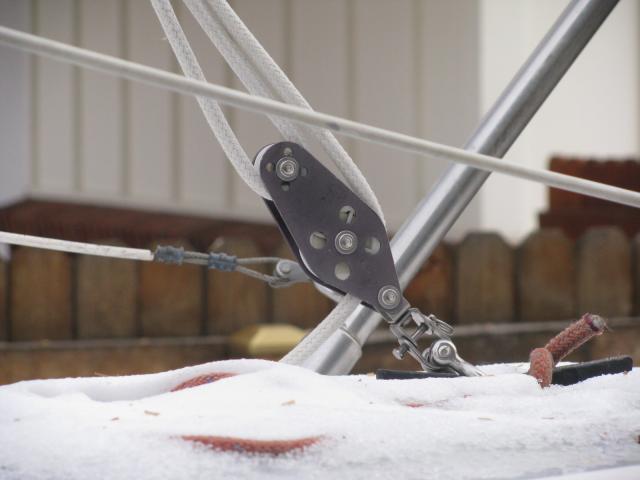

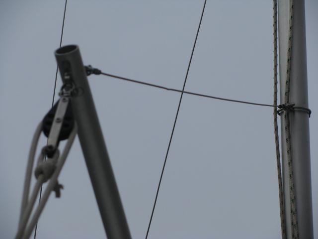

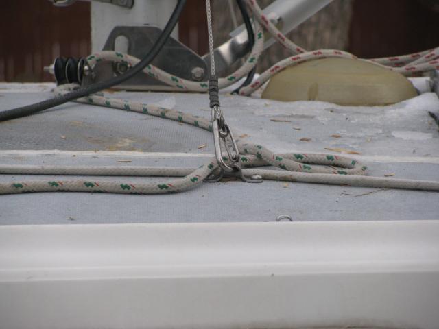

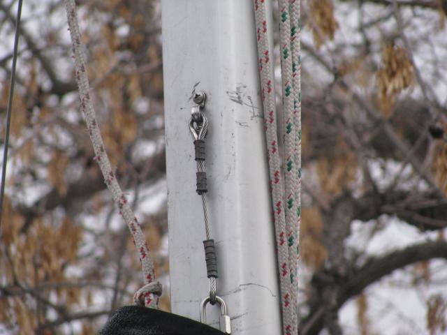

I installed the kit from BWY on my Mac 25. I attached the upper end of b-stays and the bail to lift the mast 72" from the bottom of the mast. As per the instruction sheet the lower ends are 47 inches apart on the cabin top. Mine get a little tighter when the mast is lowered all the way down.
Remember that the baby stays don't have to be that tight during the lift. A little slack is better than putting too much constant pressure on your attachment points.
Think of the baby stays as the trainer wheels on your first bike. They don't have to make constant contact, but are there to keep you from leaning too far from one side or the other.
