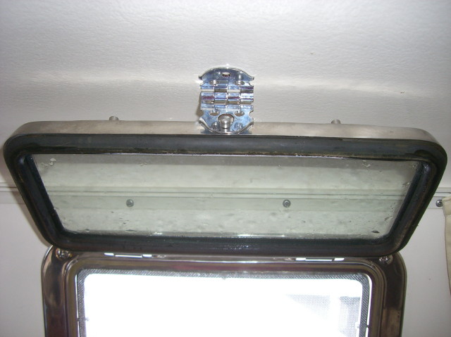

Alternative to dreaded chain
Ed;
I didn't like the idea of the chain either. Got a bunch of chromed brass small hinges. Opened one of the screw holes into a keyhole, nounted them on the overhead. Pictures tell the story. latching them open is a one handed operation. Anyone need some NFM port chains?

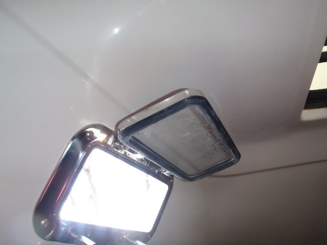

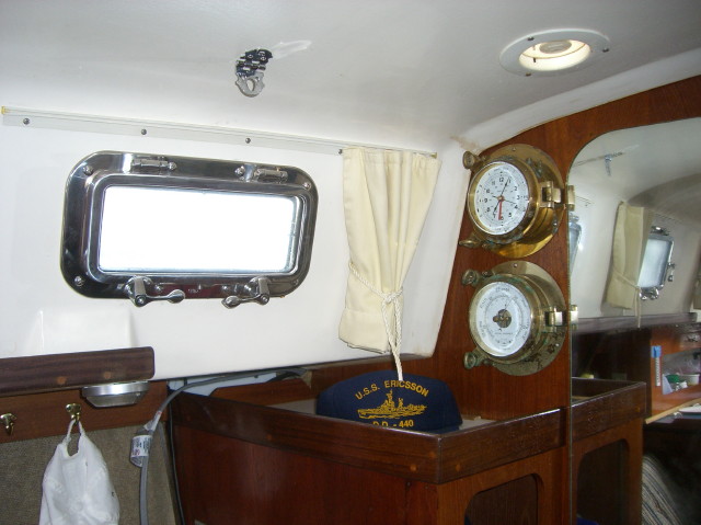

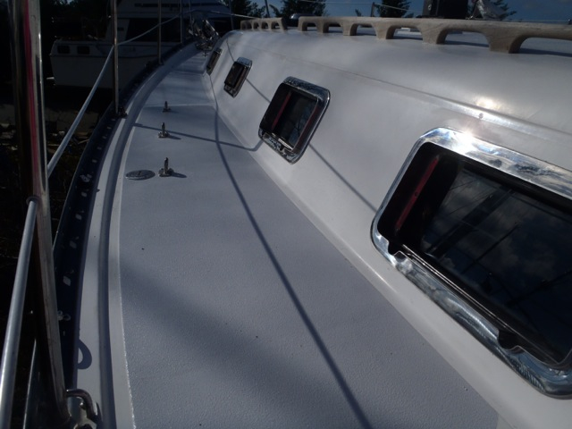

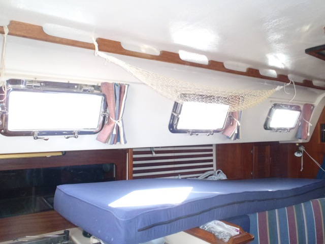

I second the NFMs. Of course I cheated and had the yard install them as I am out of the country for six months and didn't want to lose anymore sailing time upon my return
Aug 10, 2010
115
Hunter 36, Quarter Berth Model Placid Harbor, Cuckold Crk, Patuxent River
Oops, I hit submit a little too early. Here are some pictures from the wife. A few of the original ports had been replaced over the years with the plastic versions and it didn't take long for the Florida sun to wreck them. Now the boat is in Maryland where the sun isn't so rough, but the NFMs are still worth the added cost IMHO.
